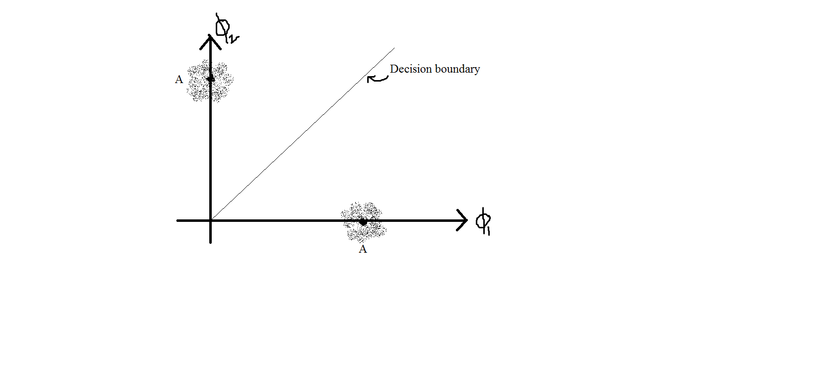

What does the noise in FSK constellation indicate? I mean you can see those clusters near the amplitude. Do they indicate a change in the frequency ??
Note that Φ1 and Φ2 are the basis function (which in this case is going to be two different frequencies that are orthogonal to each other) and 'A' is the amplitude.
Thanks in advance.
The noise in that graph looks like simple Additive White Gaussian Noise (AWGN). The source of such noise comes from various sources, including imperfections in the real RF components, the weather, etc. Because the sources are small, numerous, and unpredictable, the noise is just modeled as having a distribution of a Gaussian random variable around the constellation point. These small points in the cluster indicate the received signal after going through the noisy channel.
Oftentimes the noise is relatively constant in the environment, but the received signal power can vary (depending on the location of the transmitter). The relative difference between the received signal power can lead to a significant increase in the noise you see in the constellation (low received signal power will give a larger cluster around the constellation point).

Complex AWGN affects both amplitude and phase/frequency. Remember that when you add complex Gaussian noise, the value you add is, in fact, complex; thus, both values will change.
If, for example, you added only real AWGN, you would see only the real component in the signal change, so the clusters would not be circular, but rather horizontal lines. If you added only imaginary AWGN, you would see the imaginary component change, so the clusters would be horizontal lines.
