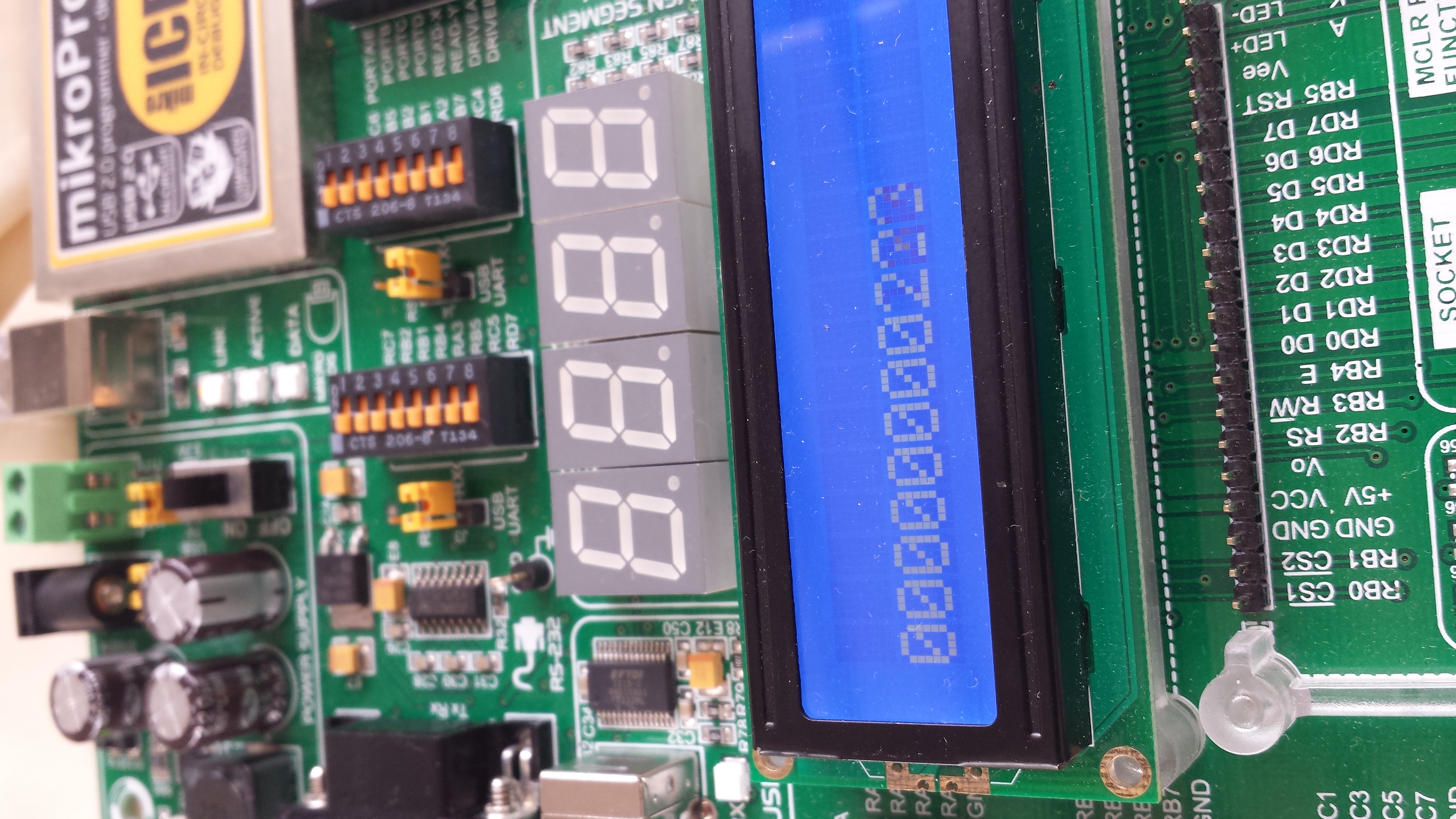

hello,
for the past week iv just started my first ever project to make a c program on the software called mikroc where i would get pulses in from the flow meter and calculate the flow rate of how much milliters flows every second which then outputs to the lcd, however, when i connected it to portd of the pic16f877a RD0, it gave random values everytime that go up and down on the lcd. please if any one knows how to make this work and whats my mistake i would really appreciate it. and sorry i am a beginner to this...

It's useless to connect a pulse output to an ADC input. Instead connect it to a counter input or interrupt capacble GPIO and make a frequency counter.
so which pin would be the best to connect to? sorry im just a beginner
Awesome, never knew that!! i changed it and now im getting values but there are lots of zeros...:bang:
link to image : https://obrazki.elektroda.pl/4171348600_1422625419.jpg
is this better? :D

1. T0CKI or T1CKI
2. INT
3. RB4 to RB7 unsing input change interrupt
I said "make a frequency counter", not use the ADC on a different pin.
IS THIS BETTER?

hello,
at firts ,Read some documents about Timer...
while(1) {
if (PORTA.F4=1){
TMR0++;
longinttostrwithzeros(tmr0,array);
Lcd_Out(2,1,array);
let's the counter TMR0 do his job..
this TMR0 , used as a counter , will count every edge on his RA4 input.. ( don't forget to add a Pull up resistor , if needed)
and use another timer (Timer1) to count elpased time.. ( 1sec or 1mn or ???)
when timer1 fire on ..
get the TMR0 value and diplay it
and RAZ TmR0
restart timer1 for next measurment.
If 1 ltr flows you want to show 1000 ml flowed ? What if 1 ml flows ? Whether you place the flow sensor horizontally or vertically then quantity of water like 10 ml or 100 ml will not even rotate the wheel inside the sensor. If you are measuring flow of only small quantity fluid then I think it is not possible to do with the this sensor but if you want to measure like 3 liter per minute and show it as x ltr/hr then it can be done.
hello,
if frequency of signal is very low, you can use diredt counting without timer
unsigned long Compteur ;
..inits for hardware and LCD
Compteur=0;
while(1) {
if (PORTA.F4==1)     // test needs == !
while(PORTA.F4==1);  // wait RA4 returns to zero
Compteur++; // yes you get a pulse
longinttostrwithzeros(Compteur,array);
Lcd_Out(2,1,array);
The frequency must be low enough ,because of the duration of convertion +LCD display !
so you will get a quantity of pulses, not a flow rate.
until you do a reset to restart from 0..
or go overcount of compter long value..
