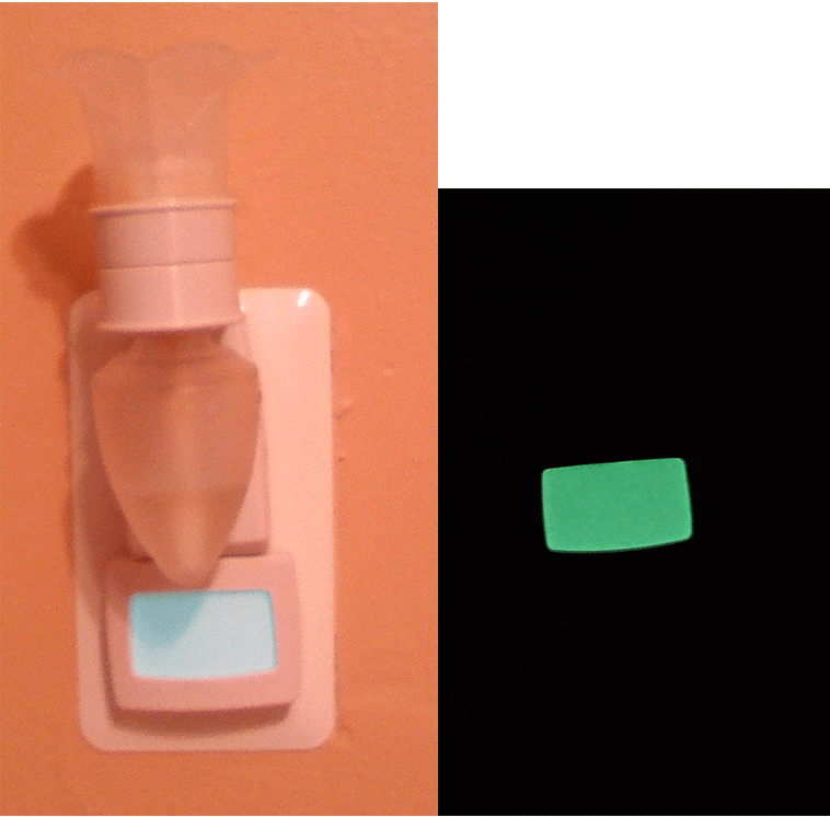

I was over a friend's house yesterday and she had a night light which illustrates exactly the kind of light I have pictured in my head for this project. Forgive the picture quality as I only had my cell phone to take a photo with.
This is what I was thinking when I said I wanted a light bar, a nice solid glow throughout, enough to see the border of the board when it gets dark outside. Am I thinking along the correct lines to accoomplish this type of thing?
Or if the glowire is this bright even at the end of its life, that still may be the ticket, for the border at least. I'll try to draw up a mock version of what design I was thinking too.
