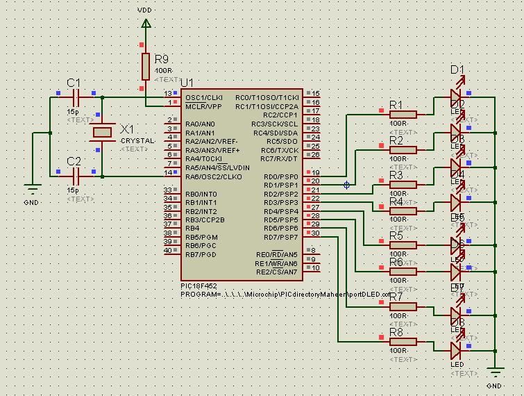

I have changed my code, the new one is OK in MPLAB, as it is successfully build and running, but I am unable to learn using PROTEUS simulator.
my code is now:

and my schematic is
I have disable WDT and set oscillator type XT.
I have made all these changes but problem persists

Well have just reloaded that code I sent and it works fine.
The message seems clear - Pin1 MCLRE is being held Low, which Resets the Pic and stops it running.
It should be held High by the Pull up resistor which is connected to 'Power' .
Does your Design show Pin 1 with a red or blue square at the side ?
Can you post your actual code and a copy of your design so I can try running it.
    V
In proteus schematic, you must put pull-up resister (10K) on MCLR pin to +Ve as suggested by wp100. It is the only solution for error appeared in proteus log.
    V
