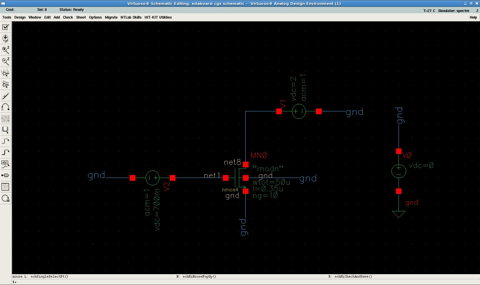

The schematic of test circuit

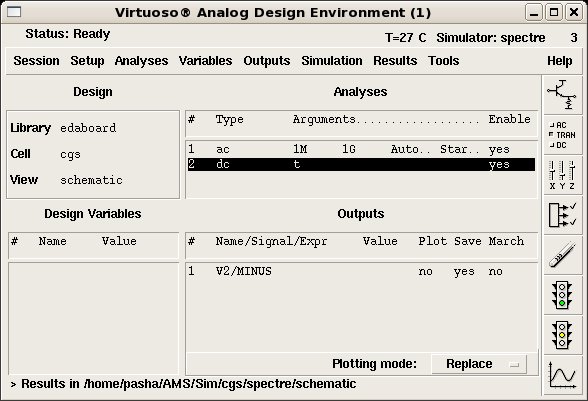

doing AC analysis

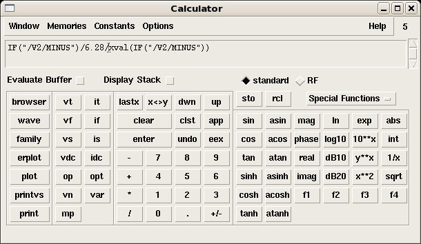

in calculator type the following
output waveform is the lower curve on picture (red), the green curve is when we set AC magnitude of V1 source equal to 0 - so that's the sum of gate-source and gate-drain capacitances
Cgs=61.12 fF, Cgd= 68.98-61.12 = 7.86 fF

i=j*w*C*Vac=j*2*pi*f*C*Vac, so if Vac =1 then C=i/(2*pi*f)
that's what i typed in calculator
