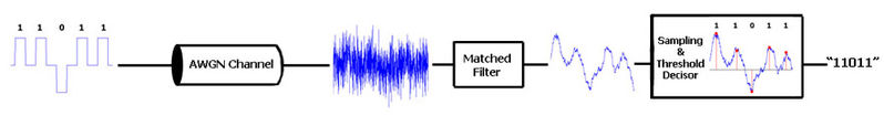

Hi everybody,
I was wondering if there's some kind of (channel) matched filter or even a whitening filter in a high speed serdes receiver???
From my theoretical knowledge it is very common in wireless receivers to improve the SNR (and afterwards to whiten the colored noise with an whitening filter) like shown in this abstract model:
But I never heard that those filters are used in wireline (or baseband) high speed data transmission.
BR Ben
