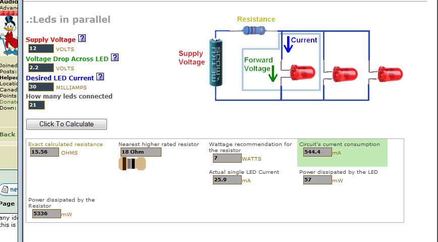

any idea what i can change resistor to?
this is what the calc says

The calculator is WRONG. You should NEVER connect LEDs in parallel.
The circuit is stupid because it wastes such a high amount of power by heating the huge resistor.
Red LEDs are probably 1.8V to 2.0V. Their max voltage might be 2.2V.
Their max allowed current is probably 30mA and they usually operate and are spec'd at 20mA.

With a 560 ohm resistor feeding 2.2V LEDs from a 12V supply, the current in the resistor (and the total current in the LEDs) is (12V - 2.2V)/560= 17.5mA. Since you have 20 LEDs in parallel then each one has a current of only 17.5mA/20= 0.875mA and they will be very dim.
The 560 ohm resistor dissipates (12V - 2.2V) x 17.5mA= 0.172W so a 1/4W resistor will be very warm.
The physical size of a resistor determines its power rating. At its power rating a resistor is hot enough to melt plastic or burn you.
use R = 25Ω , >5W
Yea the calculator told me to use a 24.5Ωresistor
and the closest one was 27Ω

LEDs have a range of voltages. Your "2.2V" ones might be 2.0V or might be 2.4V.
The 2.0V ones will be very bright and might burn out and the 2.4V ones will be dim or will not light.
That is the problem with connecting LEDs in parallel.

Try your 20 paralleled LEDs with a 560 ohm resistor and a 12V power supply. Look at the LEDs in a dark room because they will be dim. If they have different brightnesses then the brightest ones might burn out if you use 27 ohms.
Yea they got different brightnesses
as you can see on the drawing i make they should make a big E and a B (the B is the brightest)
the leds is bought in different stores
so i should "swap" the leds making the B ??
so all of them are the same type?
and i will be able to use a 27 ohm resistor?right?
