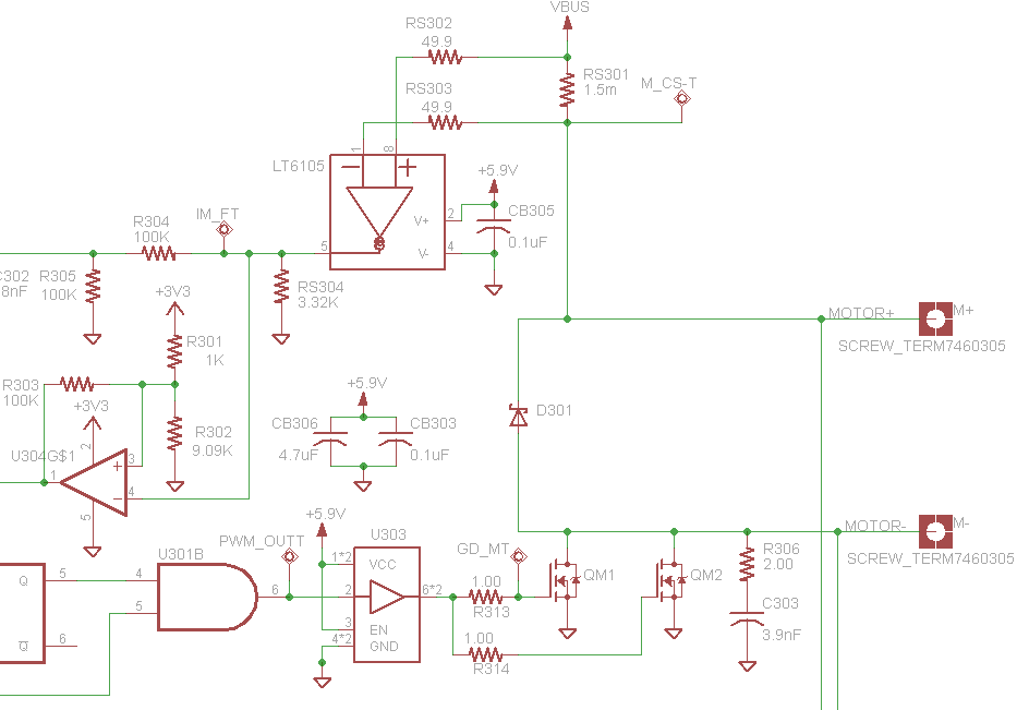

For a 15A DC chopper I want some good fault protection. I already have a high side current shunt and sense amplifier for detecting slow overcurrent, but in the event of a hard short circuit this measure would be too slow (several microseconds) to save the FETs from destruction. I was hoping to find a FET driver with desaturation detection, similar to devices like this. However all devices with desat protection have very high trip thresholds (6-8V), which is suitable for IGBTs but not for FETs. Does anyone know of a MOSFET driver with such a feature?

Here's the current schematic of the relevant section.
So I already use a high side sense resistor and a current shunt monitor LT6105, which goes to a comparator and latches the gate drive circuitry off with some discrete logic. The LT6105 takes >5us to respond, which is fine for motor stall conditions, but isn't fast enough to protect the gates from a dead short (total ESR in the circuit path is around 10-20mOhm, so the FETs would desaturate). I haven't been able to find a decent diff amp or shunt amp with fast enough response, which will work with a single supply.
Desat detection sounds a lot easier than sensing current with a shunt resistor, since it doesn't require an amplifier with high CMRR. I could definitely build such a function out of discrete components, but I'd like to avoid the cost and complexity involved, so I'm looking for a monolithic solution.
If all you want is desat detection just put a comparator on the FET drains. You will need to do the same with the gate voltages as well and only allow your desat detection to trigger while the gate voltage is above the threshold voltage for at least one FET, you don't want your desat detection to trigger while your FETs are still turning on.

I had the same doubt some time ago in a 400 V DC bus inverter. The solution we found was placing a zener diode in series with the desaturation diode! This allows a change of the desaturation voltage set value and works pretty well. It also works with more than one fast diode in series so you sum the forward voltage.

Unfortunately, while the zener diode trick would probably work, I don't think I can use it because I don't have a supply voltage in the range required by IGBT drivers with desat protection (I have 5.9V, but all the drivers I've seen take >9V). So it looks like this time I'll have to role my own circuit if I want desat protection. I'll keep that trick in mind for the future, though...
