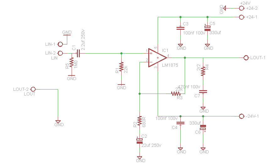

what is wrong in my circuit, i am getting poor voice quality on 40watt speaker, if i play any music i only get distorted sound.
i am using 12-0-12 transformer with bridge diode that outputs 24v DC. i am feeding sound into lm1875 from lm386.
lm386 sound output is good which i have checked with 0.5Watt speakers.

It might be worth checking your supply rails, can they supply several amps? What capacitor value do you have to get rid of the ripple after the bridge rectifier?
Also, is the circuit on a breadboard, or stripboard, or a PCB?
What heatsink have you got connected?
As a side note, it may eventually be worth replacing the LM386 with an op-amp based preamp, for higher quality (the 386 is very average quality).
I see many schematics that omit R2-R3-R4.
I believe the LM1875 is one of those audio IC's that provides its own internal bias network, to lift the non-inverting input to supply_V/2.
Also is C8 oriented at the proper polarity?
No, it's not. If he's using a single-ended supply, he needs R2, R3 and R4. C8 is the wrong way around on the schematic though.

Your first schematic shows the output capacitor is 2200 uF. Although this would normally be sufficient, there's a chance your speaker is drawing enough power at low frequencies, to cause the capacitor to distort all sounds.
At first we might think the capacitor would only attenuate lows, as a low-pass filter. However in reality it clips the peaks, causing a type of distortion known as shatter. It's the same effect as if the supply voltage is too low.
The capacitor must be large enough to pass the most intense waveforms your system puts out. Usually this turns out to be the bass frequencies, which is why it generally helps to reduce the bass.

Your second drawing doesnt show any cap in the output to the speaker... why did you take it out ?
You can put a volume control at the start if the input circuit, 10k would do
one side to GND other side to input signal and the wiper to the junction of C1, R5

The LM1875 is rated to put out 20W. This suggests it can put 12.5 V across an 8 ohm speaker. (Or 9 V across a 4 ohm.)
You are already giving it 24 VDC. It should be able to give you loud sound as it is now.
However it is dissipating heat when you run it at loud volume. Did you attach a heatsink? If the IC gets overheated then it probably goes into shutdown mode until it cools.
Try putting a finger on it to detect its temperature. If it's too hot to touch then it needs more heatsink.
Did you configure it for a certain amount of voltage gain? Say your computer puts out 1/2 VAC amplitude (a typical amount). You need over 20X voltage gain, so that the IC will deliver several volts to the speaker.
Does the supply V hold up at high volume? Or does it drop a few volts during loud passages?
At loud volume your supply needs to be able to provide over 1 amp continuous. (Or over 2 amps if your speaker is 4 ohms.) Is your transformer rated for this amount?

12-0-12V transformer will only give out +-17V, 15.6V after a full wave rectifier. This will give an output power of less than 10W, maybe 6-7W if your decoupling cap's aren't that big. You need a 18-0-18V transformer to get the most out if the LM1875.
Another thing, if the sound is bad at all sound levels it could be oscillating. The 0.1uF caps should be as close to the power pins as possible.
Also, there is no need for an output cap when running it on a dual sided supply. I'm not sure if it's any point using an input stage on this amp, is there? Isn't the input impedance all ready quite high?
