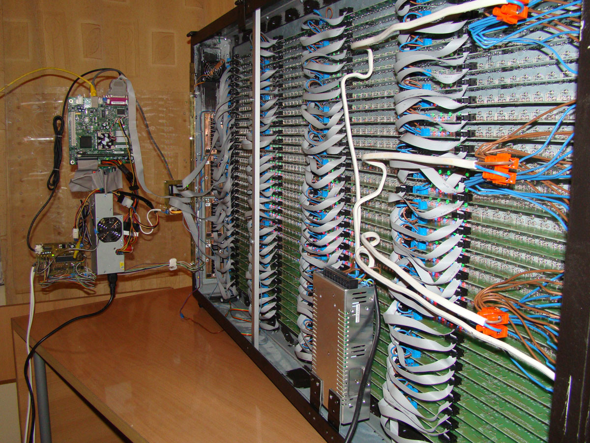

Described here component of the LED screen – LED line – is its basic element. The whole device consists of 128 such LED lines. A PC under the control of Linux Debian is a very advanced remote information display system. Cooperation with a webmaster makes it possible to start a web server, ftp, mySQL and facilitates control over the emission of video content.
LED line
The entire construction is based on LED lines connected in series, which form a row of pixels in RGB system. There are four LED lines connected in a row, what gives a total of 192 LEDs. One pixel consists of three diodes in basic colors: red, green and blue. Different levels of light of the individual diodes cause that a multicolor light spot is visible from a distance of 10 meters. As a consequence, whole rows create the screen resolution. In this case it is 64x32 spots.
