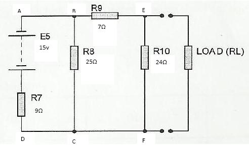

Hi Folks
I need a bit of help, My weakness is kirchoffs law and algebra, I know but I still give it a try. For this task I am required to calculate the value of the load (RL) using kirchoffs and then I have to find the maximum power transfer for the circuit. I have attempted to calculate the load (RL) using kirchoff now the bit that I am confused on is am I looking for the resistance of the Load (RL) or the current in the load (RL). Which figure is required to calculate the maximum power transfer? is it the current or resistance of the load (RL)? If it is the current is my calculations correct? and if its the resistance I need to calculate, how do I figure that out because I have no clue where to start:(

For max power transfer, RL must equal the source impedance. In this case, Rsource = R10 || (R9 + (R8 || R7))
where || means "in parallel with".

1st Yyou must calculate the voltage output (Vo=V_EF) without load (Rl=∞)
2nd Calculate the short circuit current: Isc (Rl=0)
3rd Finally Rl = Vo / Icc , corresponding to the Thevenin resistance and thus has maximum power.

the way I would do it, would be to take the loop ABCD and see how it reacts.
So Vo = 25/34 X 15 = 10.71volts and its internal resistance is 9 in parallel with 25 = 225/34 = 6.167 ohms
now add on loop EF
so we have A 10.712 battery with 6.167 + 7 in series and a 24 ohm load, so new Vo = 24/27.167 volts = 9.463 V with 13.167 in parallel with 24 = 13.167 X 24/37.167 = 8.5 ohms in series.
So for Pmax Rl = 8.5 ohms. The voltage across it is .5 X Vo = 9.463/2 = 4.732, so Po = 4.732 X 4.732 /8.5 = 2.634 Watts

Without load you got I2=.293A ==> Vo = 24*I2 = 7.032V
Now the 2nd part: Isc
(9+25)*I1 - 25*I2 = 15
-25*I1 + (25+7)*I2 = 0 <-- short circuit at R10
solving system... Isc = I2 = 0.81A
Finally: Rmaxpow = Rthev = Vo/Isc = 8.68ohm
That match the suggestion of godfreyl (the shortest path): R10 || (R9 + (R8 || R7)) = 1/(1/24+1/(7+1/(1/9+1/25))) = 8.688037529

I worked it out like this:
  1. Firstly, start with just the battery and R7. That gives you a voltage source of 15V with a source impedance of 9Ω
  2. Now add R8 to the circuit. R7 and R8 form a voltage divider, so now voltage = 15V*R8/(R7+R8) = 11.03V and source impedance = R7||R8 = 6.62Ω
  3. Now add R9 to the circuit. Voltage is still 11.03V, but now source impedance = 6.62Ω+R9 = 13.62Ω
  4. Finally, add R10. This makes a voltage divider again. The voltage across R10 = 11.03V*R10/(R10+13.62Ω) = 7.04V and the impedance = R10||13.62Ω = 8.69Ω
So the open circuit voltage is 7.04V and the source impedance is 8.69Ω.
Short circuit current = 7.04V/8.69Ω = 810mA.
Optimum load resistance for max power = source impedance = 8.69Ω.

In the PDF you wrote:
Loop ABCD
15 = 9I1 + 25(I1-I2) = 34I1 - 25I2 (eq1)
Loop BEFC
0 = 7I2 + 25(I2-I1) + 24I2= -25I1 + 56I2 (eq2)
Right?
Then you solve the system for the variable I2 doing:
25 x eq1 + 34 x eq2 --> 375 = 1279I2 --> I2 = .293
Right?
But... What is represented by I2? --> Is the current at R10 when Rl is disconected.

Now the 2nd step: Short circuit.
Loop ABCD
Loop BEFC
0 = 7I2 + 25(I2-I1) = -25I1 + 32I2 (eq2) <-- because R10 is shorted
Right?
25 x eq1 + 34 x eq2 --> 375 = 463I2 --> I2 = .81
Right?

Hi again before I hand this paper in I just wanted to see if I was on the right lines I've understood what everything means, but I am struggling to present my work in the manner it was requested. I have drew some diagrams and wrote the equations but I just want to know if the format of the diagrams and equations are correct? I understand that after working out I2 with kirchoffs we then focused on finding the resistance for RL using thevenins equivalent but I just wanted to know if my diagrams and the way I wrote my equations are correct?
  • Max power.pdf
Hi
First page, second line under "Loop ABCD":
"15v = 10ΩI₁+ 25ΩI₁ - 25ΩI₂" should be "15v = 9ΩI₁+ 25ΩI₁ - 25ΩI₂"
Second page, first line:
"Vo = 0.293a * 24ΩI² = 7.032v" should be "Vo = 0.293a * 24Ω = 7.032v"
The calculation of ISC is complete nonsense, even if it gives the correct answer.
