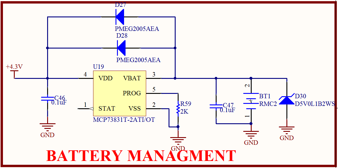

I charging phones Li-Ion/Li-Po batteries and Li-Ion 18650 with this, and Ic is real warrior. :smile:
Charging current is set with resistor (2K on illustration) with formula given in datasheet :
Ireg (mA) = 1000V / Rprog (in KΩ)
According to 2x4,7KΩ its 9,4KΩ and that set current to 106mA.
IC is connected to copper on PCB ?
You must use capacitors!
Check input voltage!

I am using MCP73831 & the marking on the device is KD9Q.... Ic warm little but its not an issue... My circuit....
