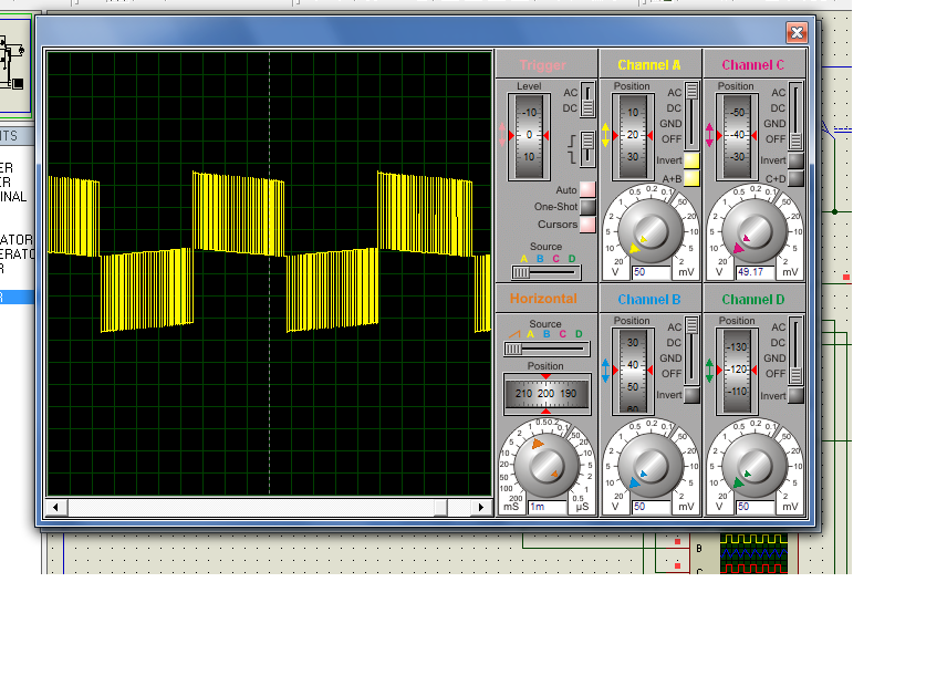

hello
red_alert and all
i had follow the spwm technique for single pahse inverter.
please suggest me i am going right or any suggestion for improvement
these are output wave forms
The wave forms look OK (though they're pretty unclear).
Anyway, you have to check that while one low-side switch is kept in the ON state, the other leg high-side switch is following the sine PWM signal (with an ascending then descending duty cycle) and the corresponding low-side switch is driven by a complementary signal (don't forget about dead times though).

these results are made by isis proteus right ? why donot u try orcad pspice simulation it is more accurate and realistic . otherwise the results seem normal , but u need to try the circuit and see real life measurments .
