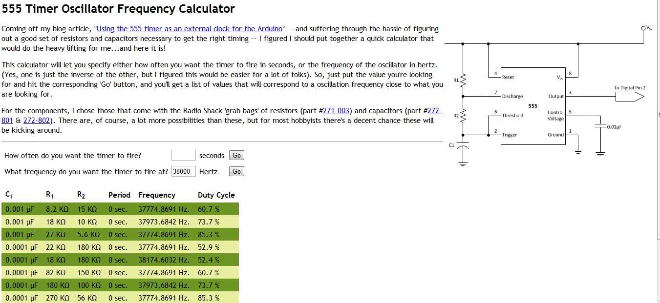

do u use any simulator like protious...?? its better to experiment there first if things going right there then try in real time producing a 38Khz frequency is not a difficult task if you read datasheet properly...... sir FVM and sir jpanhalt are the most experienced person here for you and guiding you toward formulas to calulate the values of resistance and capacitor ....you can use online calulator to calulate thies values if i free soon i will give protious files of 555 based 38khz frequency generator...........
---------- Post added at 20:43 ---------- Previous post was at 20:35 ----------
555 Timer Oscillator Frequency Calculator
use the above link just enter the frequency and get the components values...
