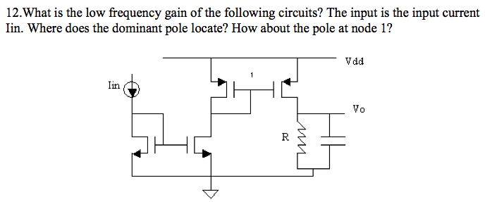

Nov 8, 2012 #1 A analog_curious Member level 2 Joined Feb 17, 2012 Messages 46 Helped 3 Reputation 6 Reaction score 3 Trophy points 1,288 Location Ireland Activity points 1,682 Hi all, Please suggest me the way to approach this question. I guess that the dominant pole in this circuit is due to R and C in the load circuit.Am I correct or.. Dan
Nov 8, 2012 #2 P pedroromanvr Member level 1 Joined Oct 13, 2012 Messages 37 Helped 6 Reputation 12 Reaction score 6 Trophy points 1,288 Activity points 1,455 These circuit uses current mirrors. Yes the dominant pole is obtained from the R-C circuit, the gain is about R/(RCs + 1).
Nov 9, 2012 #3 A analog_curious Member level 2 Joined Feb 17, 2012 Messages 46 Helped 3 Reputation 6 Reaction score 3 Trophy points 1,288 Location Ireland Activity points 1,682 thanks how about the pole at node 1? Dan
