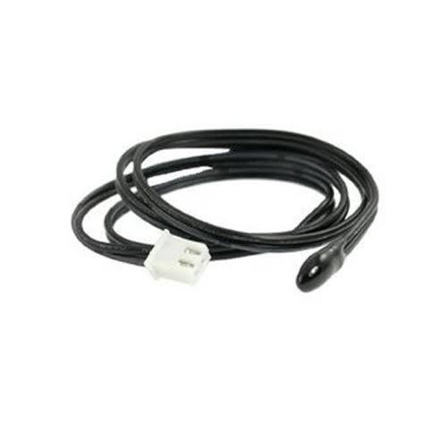

I am having an air conditioner temperature sensor for ambient temperature measurement, which value is not in linearity. How to make out the temperature by using only the ADC Value to get degrees in the C code like any formulas.
For a example this is my temperature sensor chart:

You need to know your sensor's voltage(resistance)/temperature relationship. You don't tell us if it's a thermistor, RTD, thermocouple, diode or what. The manufacturer should provide that information.
There are numerous regression calculator websites on the web on which you can insert the above input/output table, obviously selecting just one pair of parameter ( e.g : Celsius / ADC value ). These tools give you the formula that estimates with a reasonable accuracy the output value depending on the function chosen for this, usually polynomial of order 2 or 3. You can try this one, seems promising: https://planetcalc.com/5992/

The resistance curve seems to show a 5k NTC. To calculate the translation to voltage and ADC value, you need to know the circuit, apparently a voltage divider. The transfer function can be calculated using the formulas given in NTC application literature.
For the apparently very small temperature interval, it can be easily fitted by polynomial, as discussed above.
