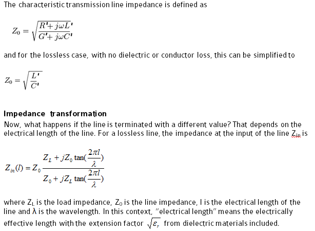

Below is link talking about the PLL operating at 75GHz: http://cc.ee.ntu.edu.tw/~jrilee/publications/75G_pll_J.pdf
Could any experts explain me how to convert the VCO loaded with lossy transmission line to equivalent VCO loaded with lumped inductor?
I mean, how to calculate the equivalent inductance of the lumped inductor.
I am quite baffled with that.
Thanks a lot.
If you can get the S-Parameters, I feel that you can get the equivalent lumped result readily.
Second, Matlab RF Toolbox has an example to fit S-Parameters to a lumped network (sum of rational functions).
Attached is the math to calculate the loaded impedance, if you know the line impedance Z0 and load ZL.
