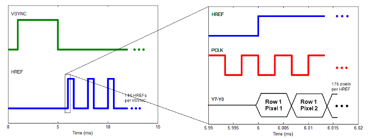

the above logic i used to arrange the pixels in form of image.... vsync ,hsync and pclk are the timing signals and the maner in which pixels come out is shown in figure below:

Anyway, the thing that concerns me is that you don't have any way to synchronise the pixel counters. You should be looking for positive transitions of VSYNC and resetting HCNT and VCNT, and for positive transitions of HSYNC and resetting HCNT (if my understanding of your waveform diagram is correct). It's generally a bad idea to assume that everything will start in sync and stay in sync!

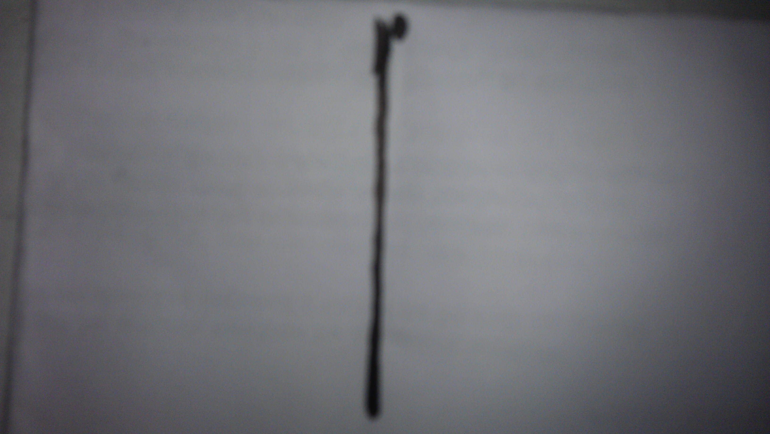

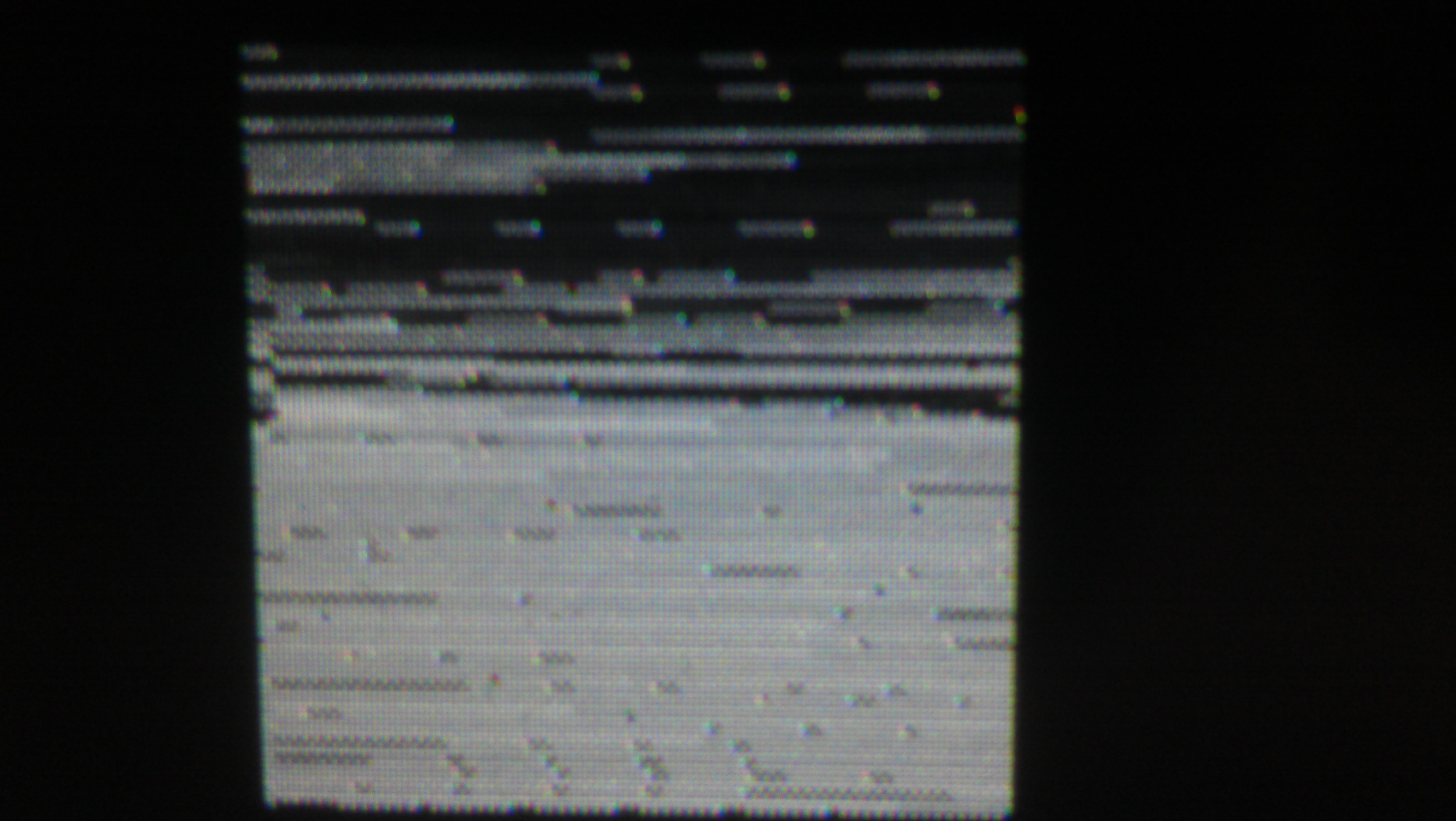

The picture captured from the camera and displayed on lcd is shown in figure below (right side) and the picture i tried to capture is also shown below (left side)...
it is difficult to deduce from the above picture where the error may be because i tried to capture the horizontal black line instead of vertical but obtained nearly similar output image
what format is the camera?
what format can the LCD accept?
if the two dont accept the same formats, the you will need to do a format conversion
