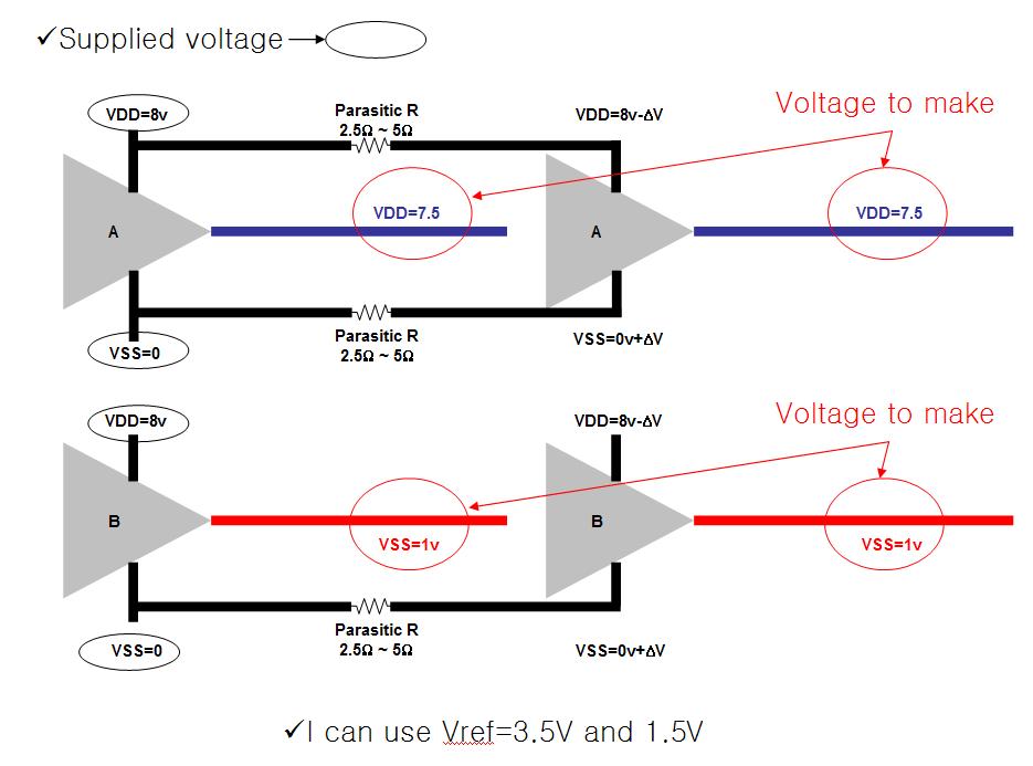

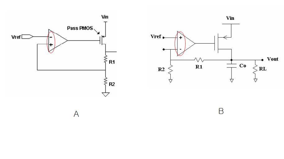

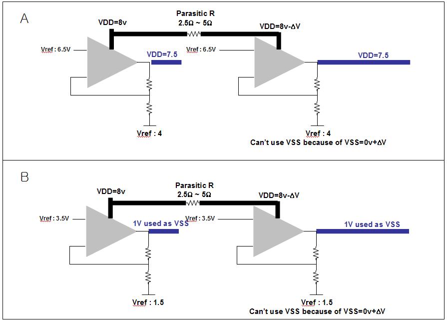

hr_rezaee said:Hi
yes, Fig A is true.
As I know you must buffer output.
(current can effects on thid circuit)
If you use buffer, it can sink and source current and there will be no problem.
