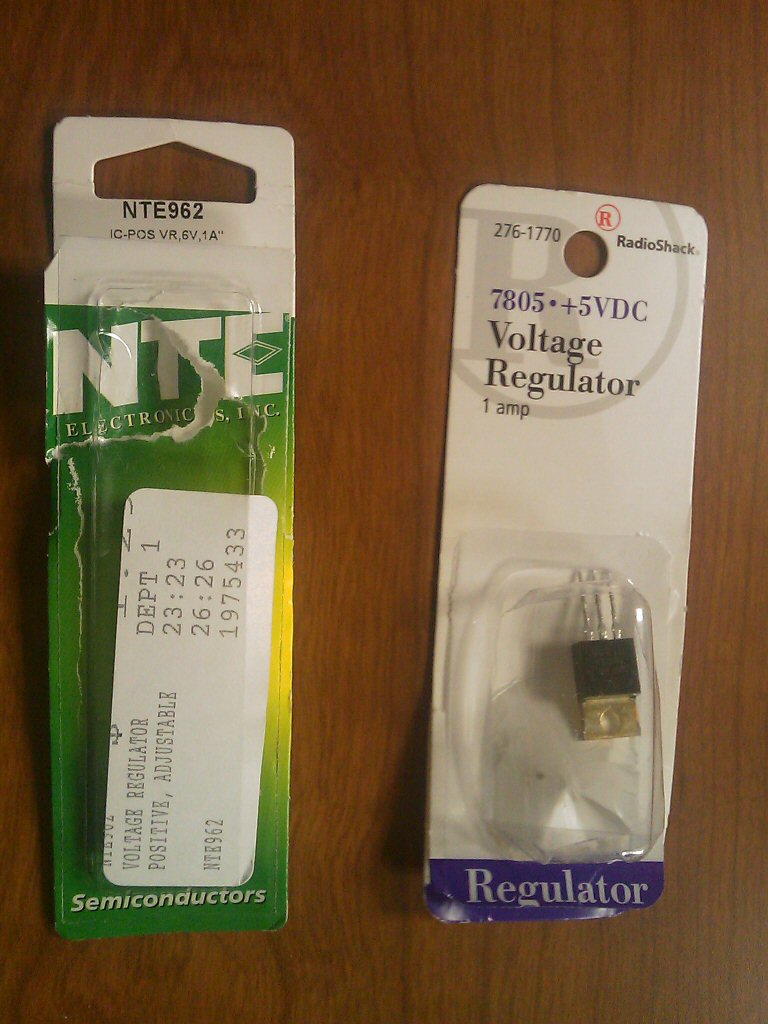

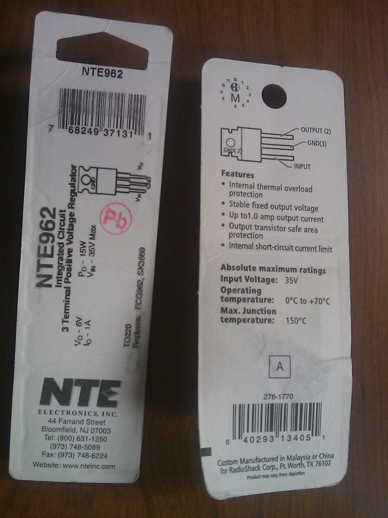

These are pictures of the voltage regulators.
http://www.ghettobsd.org/misc/IMAGE_186.jpg
http://www.ghettobsd.org/misc/IMAGE_187.jpg

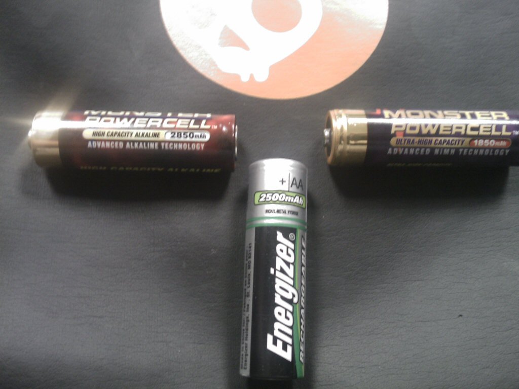

These are pictures of batteries.
http://www.ghettobsd.org/misc/IMAGE_189.jpg
The rechargeable batteries have the following output (at almost full capacity charge):
8 AA 1850 mAh nimh = 10.6 V
8 AA 1850 mAh nimh = 1.74 mA
4 AA 1850 mAh nimh = 5.25 V
4 AA 1850 mAh nimh = 660 mA

4) Well i'm using rechargeable batteries. I found out that alkaline AA's are 1.5v and rechargeable are 1.2v. Their capacities are about 1850 (originally) but have been around for a while.

You forgot to tell us the spec's for your AA rechargeable cells. Are they old low-capacity Ni-Cads or high capacity Ni-MH?
Name-brand Ni-MH AA cells have a 2500mAh rating and can supply 650mA for 3.8 hours.
Using the same size battery (AA cells) but with more of them and a regulator does not reduce the current so the life of each charge will be nearly the same as before.

The rechargeable's i'm using are ni-mh 1850 mAh. (8 of these - used for i'd say 2 years now but with a charger that conditions them)

Which regulator are you using? Its datasheet tells you its minimum input voltage for it to regulate, probably it is 7.5V. The minimum input voltage is its output voltage plus its dropout voltage.
Why are you using extra battery cells and a voltage regulator? The life of each charge will be about the same as with 4 battery cells.
I got a VR that says its a 6v 1A VR. It has 3 pins, v-in, g, and v-out. That's pretty much all there is to it. I got it from Fry's Electronics so it doesn't come with anything else than that.

Although Fry's has most likely no datasheets for their devices, all ICs are from NTE, a reseller. Your regulator is NTE-962, and it has a datasheet, but rather scanty. If you need more information, you can refer to a similar original manufacturer's type as 7806.

I've updated the first post with some more information and values regarding my batteries. I also noticed that I had in other use a monster cell that was "high capacity alkaline" and it claimed to have 2850 mAh... if that is high capacity, then the 2500 mAh nimh would work just as well right?

You were correct about the regulator being NTE-962. I did end up getting a 5v, 1A regulator from radio shack since I saw they had it, but now I know that isn't going to be the only thing I need.
