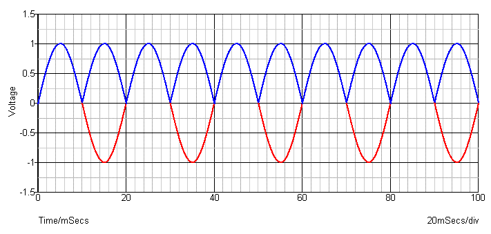

I have this circuit (Battery ampere hour monitor)and have a basic idea of how it works but would like to understand it a bit better. The principle of the circuit is that it's a bidirectional current flow monitor a 0-60mv signal comes in through X1 from 60amp shunt and it gets fed and amplified through IC1A then IC2A,B converts the signal to a positive value if the current is reversed. The part I'm un-sure of what is the purpose of R7,C2,D1,T1 and R10 does I presume it as something to do in converting the signal from a negative into a positive signal when the current flow is reversed ? . The rectified signal get's fed into IC1B. The output has a range of 0-1.8volts with 0-30amps current draw
Could someone please clarify this for me

With the transistor connected like that, it's just going to behave like a diode.
I redrew the circuit as shown below to (hopefully) make it easier to understand, with the transistor replaced by diode D2.
According to my simulator, the circuit works as a precision rectifier. In the trace below, blue is the output, and red (partly obscured by blue) is the input.
The capacitor is presumably there to ensure HF stability of IC2A.

I've been doing some more playing. It turns out when I looked close at T1 it turns out to be a Mosfet (2N3819) and not a transistor as I first thought(must remember to wear my glasses while reading) here is what I have put together and will try and explain it as best as I can.
With 25mv current flowing into the battery in on X1&2 with .73V on PIns 3&2 and 1.46V coming out of IC1A going into IC2A pins 3(+) pin(2) is 1.46 coming out of pin 1 is 1.67 then this goes onto the gate of the mosfet and at the other side of the diode there is 1.46V same voltage into IC2B and IC1B then a positive voltage out of IC1B. Then when current flows out of the battery there is a -25Mv going on X1&2 with -.73V on PIns 3&2 and- 1.46V coming out of IC1A going into IC2A pins 3(+) pin(2) is -1.46V coming out of pin 1 is 1.93V then this goes onto the gate of the mosfet and at the other side of the diode there is -1.46V then goining into pins 2&3 there is .01V and coming out of pin 7 (IC2B) there is +1.46V then a +1.46V coming out of pin 7 of IC1B. I do now have a better understanding of how it works and like the idea of a precision rectifier.
Would the mosfet still act like a diode with the Drain and source pins shorted ?
Thanks for taking the time to play and help
The 2N3819 is a JFET, not a MOSFET. It will act like a diode with the source and drain connected together. A MOSFET would simply act as an open-circuit.
