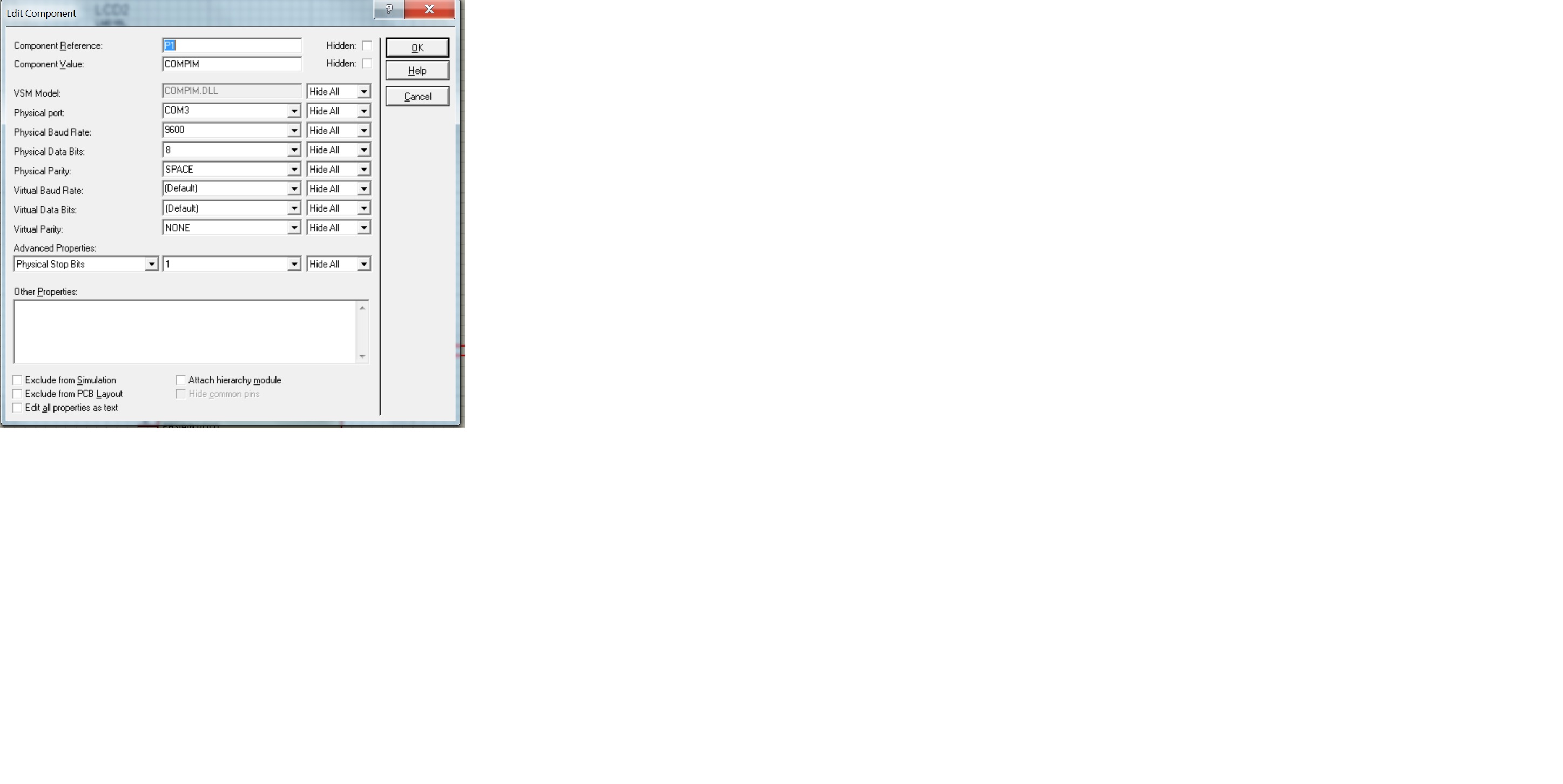

Thank You all for trying to help me...The problem is solved. I still have a doubt.
I tried using slave device design on new .dsn file. And I used COMPIM component and connected it to microcontroller. So I run the simulation of the slave design and then the master design. I got the output when I changed the COMPIM setting as shown in the attached figure(Just tried trail and error).
Now my doubt is why this did not work when we connected master and slaves directly??
