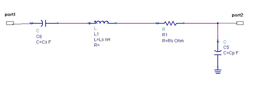

Capacitor structure is below.
I thought equivalent circuit like this circuit.
I don't know exactly that the equivalent circuit is right.
so plz tell me what is problem~^^
This model makes sense, if the capacitor is small compared to the wavelength.
