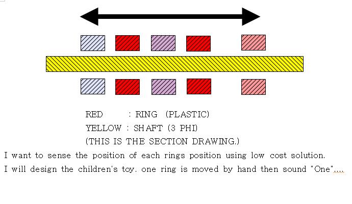

I want to design the system as follows.
Please give me the idea.
1. There are rings on the shaft.
the ring is made by plastic and the shaft is steel.
2. user will operate up and down the ring
I want to check the position the ring by very very low cost self made sensor.
total rings are 10 or over.
But environment is very dusy so I can not light sensor.
and also the ring's material could be changable....
Does anyone have th idea for this ?
Help me
Approximate sensor

Approximate sensor
This is the drawing ...
Please check it everybody.
Approximate sensor
I want to check the each position of rings.
Because the operation will be occured randomly.
Thanks a lot.
Re: Approximate sensor
Would be probably better solved by designing the sensor function into the construction from the start rather than supplementig it later, as it seems to be the case now. Some material choices or form factors may be adapted to the measurement requírements then. Integrating the measurement in the shaft is one option.
Generally, if optical sensing is regarded unsuitable, a capacitive proximity switch would be the next obvious solution for plastic objects, apart from ultrasonic or mechanical feelers.
