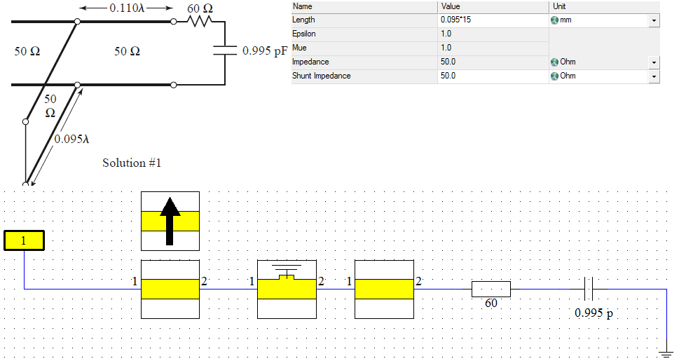

Hello everybody, I have a problem in simulating single stub tuning in CST Design studio , the problem is
1 - general transmission line is two port , i don't know how to connect it with a resistor,although connecting resistor to the ground often gives me right answers, but when i try to calculate S parameter while using single stub in TL ,it's answers are very wrong and unreal , even it doesn't answer 0 in center frequency , for exmaple i tried to simulate one of the examples of POZAR book , but it's answer is wrong ,
2 - even with a coax cable or coupled trans line i got wrong answers,
thank u for your HEeeeeeeeeeeeeeelp!
Can you post a pic of your simulation setup? Would be much easier to understand your problem!
To be sure: is your problem how to use the SW or how to calculate the length of the transmission line and the length of the stub?
thank you WimRFP,but I know the length of the tras line and the length of the stub ,because it is one of the examples of Pozar book, titled microwave engineering , i haven't change the numbers in CST , my problem is the software is turning back wrong answers , i used the Transmission line model in CST Design .
Did you check it with a hand calculation (or easier Smith chart) to make sure you know what to expect? I'm sorry I can't help with the SW.
thank you again WinRFP, yes i checked it with a calculator manually, and the circuit must be matched in 2GHz ,(S11=0) .i think that i have a problem with cst design enviroment
Hello mohammaddmt,
there are many possible problems which can cause a mismatch. Maybe you upload your CST-file and will check it, maybe easier. Which CST version you are using.
Kind regards!
Johnjoe
thank you very much johnjoe , ok , now i upload my files , my CST version is 2011 .this folder has 4 files , that has four diefferent ideas for the image that i put above, thank you very much for your consideration . **broken link removed** you have to wait 10 seconds , thanks,note that the 404 Error is a popup , the original link is working,

Hi again everybody, right now i simulate this circuit with ADS , and it answered pretty good , so the conclusion is "just for these kinds of simulation" it's better to use ADS rather than CST , thank you all very much.
