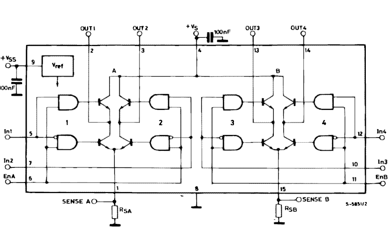

h bridge - please clear my doubts

the diagram that is made on the given link is fake the actual internal circuit of L298 should look like this

hi
in truth table
1 mean transistor on
0 mean transistor off
but in control side for transistor
0v----> for (A) or (b) mean pnp transistor on
12v---> for (A) or (b) mean pnp transistor off
12v---> for (c) or (d) mean npn transistor on
0v-----> for (c) or (d) mean npn transistor off

i think he ask about pnp transistor in that circuit

Re: h bridge
YES this is what i want to know
