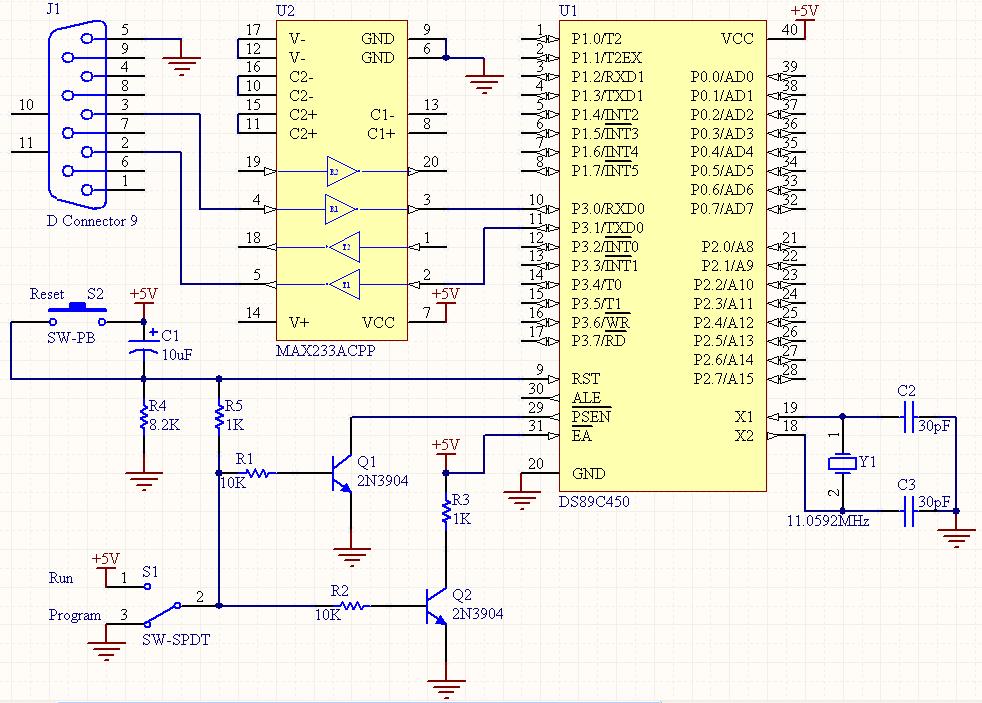

Anyone please tell me how to program and run the DS89C450 without the use of a 74HC125. Because I only got the MAX233 chips and DS89C450.
You can use mechanical switch on the place of HC125, so every time when you wont to switch program/run mode, do it manual.
Thank you Josiphal.
Finally i found this schematic from book, but it doesnt work at all.
Can anyone please tell me what the problem on this circuit?
I am also finding anser of above quetion(?).....
I have diagram in book..
