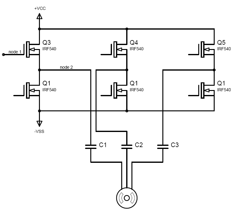

Now, please assume circuit below:
1) Assume VCC = 15V, and we need Vgs = 10V for turning on the upper arm N-MOS. so (node1 - node2 = 10V). actually the voltage of node 2 is not fixed and it may have any voltages. so how will you adjust the voltage of node 1 in order to have 10 V between node 1 and node 2 !?
2) Is there any solution in order to replace Ground with -VSS?
3) How do you calculate the value of c1, c2 and c3? if we use them, do we still have square wave form in the Motor input? don't these capacitors limit the current of Motor? ( Motor is 3~10A )
Dear GoldSmith, I think a perfect schematic can distinguish as well.
Thanks in advanced
To provide a Vgs of 10v you can either provide 10v from an isolated voltage source or use a bootstrap circuit to generate a higher voltage and use it to drive the gate (or an external voltage pump to generate the voltage).
In the isolated supply method it is like having a battery, suppose a 10v battery, you connect the minus pole to the mosfet source and the positive to the gate, in that case the gate will always have a Vsource+10v voltage and the Vgs will be 10v
The bootstrap method charges a capacitor to the supply voltage level and then when the high side mosfet turns on the capacitor voltage works again like a battery to provide to the gate the source voltage + Vcap so the proper Vgs is accomplished.
Your capacitors are in series with the motor (load), I don't think that this can work properly.
A negative supply can probably be used but ? haven't done anything similar and I don't see the point, also the driver of the lowers side mosfet would become more complicated

@Alex:
if ask some solutions for replacing Ground with -VSS, it's because of that I have single supply. maybe I should shift controller part approximately VCC/2.
I know bootstrap technique, however I'm not familiar with isolated voltage source. can you take an example or leave some schematic from isolated voltage source?
An isolated power supply is just a power supply that is floating and doesn't share the same gnd as the rest of the circuit, this way the reference of this source can be connected to the high side mosfet source and actually be added on what ever voltage exists there and this creates the Vgs
What I describe is like this
I haven't used anything like that, but it is similar to a transformer coupled gate driver
