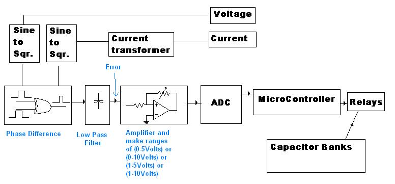

I need to make up the Power Factor Controller for the final year project. Actually that's my friend project. He got around 6 months to compete that project, but he couldn't with group of 4 people, they had done nothing in the project so far. Now their group leader is asking me to complete his project. I believe his knowledge of electronic is poor, but on the other hand he has the highest grades achieved so far in graduation. I'll be free on 16th May 08 and their submission is on 19th May 08. I don't have enough time to carry up the research work on this. Friend of mine told me that somebody advises him to use a small matrix of capacitor on the line load and with help of relays switch them. Measure up the voltage and current phase difference and calculate the offset, according to the offset values switch capacitors accordingly with microcontroller or something.He told me he'll use the Current transformer for that. The load would be made by the autotransformer, those guys purchased the autotransformer working from line frequency. He said, it's kind of dummy inductive load for that. In short, the purpose is that when the inductive load on the line increases, the capacitors get connected on the line with relays.He also said they'll also have a zero cross detector.
I appreciate if anybody could help me as how to implement it in the block form. I'll make the circuit for that or if you have any circuit schematic on that, that would be very helpful. It's not my work so I'm not worried.Neither I care whether this final year project will be completed within 2-3 days or not! I'll try my best to make up their project.

What you need to do is to measure the phase angle between the system voltage and current which will be lagging without any capacitance connected. I suppose you can do this easily using some of the energy meter ICs ( or may be phase angle ICs also may be there?). Then the controller should then switch On/OFF the capacitors to/from the line to minimise the phase angle.

The comparator and XOR circuit is very simple robust phase detector indeed. I'have used it previously to monitor the phase of audio signals.
However, for reactive power compensation, I think it's more important to measure the reactive current component as a signed value rather than the phase angle or power factor as input value for the controller. This value may be monitored additionally.
The reactive current directly maps to a number of capacitors to be switched on or of, while the real current is basically unimportant for the controller.
A measuring circuit for reactive current can be made from a 90° phase shift for voltage reference input (an integrator is favoured as it also suppresses harmonics), a comparator and a synchronous rectifier (or demodulator).

This shows clearly what they want ..I think .:?:
So it would be an overkill to use a signed phase value , as it will always (in this case) in the same direction.
The higher the load on the transformer the closer to 1 cos Phi will be......

A transformer (may be an auto- or isolation transformer) has mainly reactive idle current, but only a few % of nominal load current. So the transformer is a light load that sinks only small amounts of reactive power.
The system specification shouldn't be defined from an existing test load but from real load cases, e. g. asynchronous induction motors used in HVAC or electrical machines.

Here is the idea that I have on my mind for implementing it.I had a chat with their group leader and he told me that they had to use the microcontroller and he told me that they had mention the name of 89C51. He told me it doesn't matter what the controller is doing, even if it's just flashing up the few LEDs, but it has to be there or it would be soldered into the board with no connection with other circuit it would look as if the controller is functioning in the circuit, but there won't be any program in it's EPROM and it won't be running and won't have the power connection, because those guys have submitted their final year project file before even they made up the project , they had made final 6 copies of project file and had submitted them to their Internal Project Advisor, External Project Advisor, and other four for themselves, as they are four.

When using the phase angle or power factor as controller input, you have a varying control process gain, depending on the unknown real power. Switching a single capacitor can either result in a few % or full scale change of power factor.
The misunderstanding is probably suggested by the term power factor controller. Actually it's rather a reactive power compensator. Using reactive power respectively current as controller input, you get constant control process gain and easy and stable controller operation.
Apart from general considerations, what's a suitable input measurement for a power factor controller, your design has to be supplemented to my opinion. It is unable to determine the power factor sign, an additional flip-flop is required to achieve this.
P.S.: To consider state of the art for your design, see the manual of an industrial standard power factor controller. It has interesting features as automatic identification of connected capacitors.
