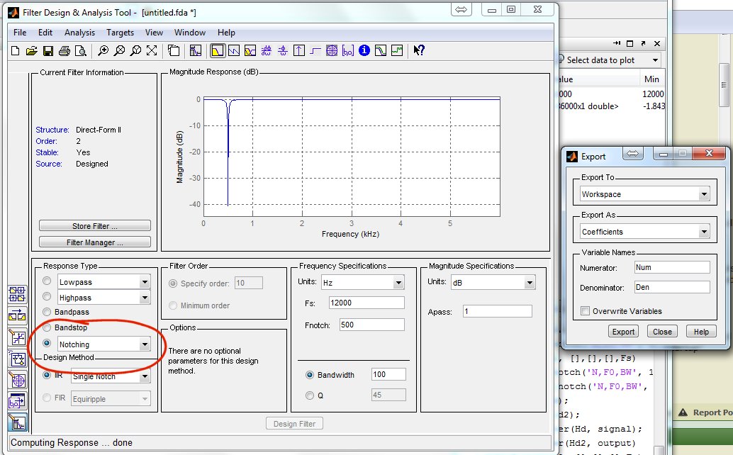

I have a project to filter a jamming signal

Good evening tryipod,
What an interesting way to pose a problem!
There are so many ways to jam/obscure a signal, I took a guess that your signal was being masked by the addition of something else, and indeed it was... let me paste my solution script here and walk you through it:

The pwelch() function provides a convenient front-end for spectral estimation tasks - here, I've invoked it with a minimum of arguments to quickly examine the overall form of the file's spectrum. The default parameters are quite useful, and clearly reveal the presence of two equal-amplitude pure tones (at 500 Hz and 5 kHz) in the data. Given their amplitudes were equal I assumed these were the jamming tones, and set out to remove them.
You *can* use fdatool for the filter design (selecting the appropriate filter shape in the 'response type' field at lower left), but here I've specified the filter parameters as arguments to fdesign.xxxxx(); After unsuccessfully low-pass filtering the signal (which certainly hammered the amplitudes of the jamming tones down, but rendered the audio uncomprehensible) I decided to just notch out the tones - and that worked a treat :)
The sound() function then plays the audio file through the PC's audio output... and there's your answer!
[The result obtained could certainly be improved substantially from this first pass though. Optimisation of the notch order and bandwidth might improve the recovered audio, and using a non-causal filter such as the filtfilt() function would eliminate the audible 'pop' at the start of the audio due to the filter's numerical "startup" overhead.]
Enjoy - it sounds like you've got a good DSP teacher :)

No, unfortunately you can't use fdatool to examine a signal spectrum - it's just a graphical interface to the filter designing engine. There might be an interactive tool somewhere in MATLAB, but I find pwelch() does everything I need.
[You can find online help about any MATLAB functions with either: doc <function> ...(the verbose, HTML version) or... help <function> ...(the concise, text format)]
doc fft will display the help file for the inbuilt fast fourier transform function, and another approach to spectral estimation is discussed about half-way down the page.
To use fdatool, select a 'notching' response as per the attached screenshot:
You can then export the coefficients using the File/Export... menu selection.
With the coefficients in the workspace, you can filter your signal this way:
>> oneToneGone = filtfilt(Num, Den, signal);
%%% Go into fdatool and design the other filter...
>> bothTonesGone = filtfilt(Num, Den, oneToneGone );
%% Done! Listen with:
>> sound(bothTonesGone, Fs);
