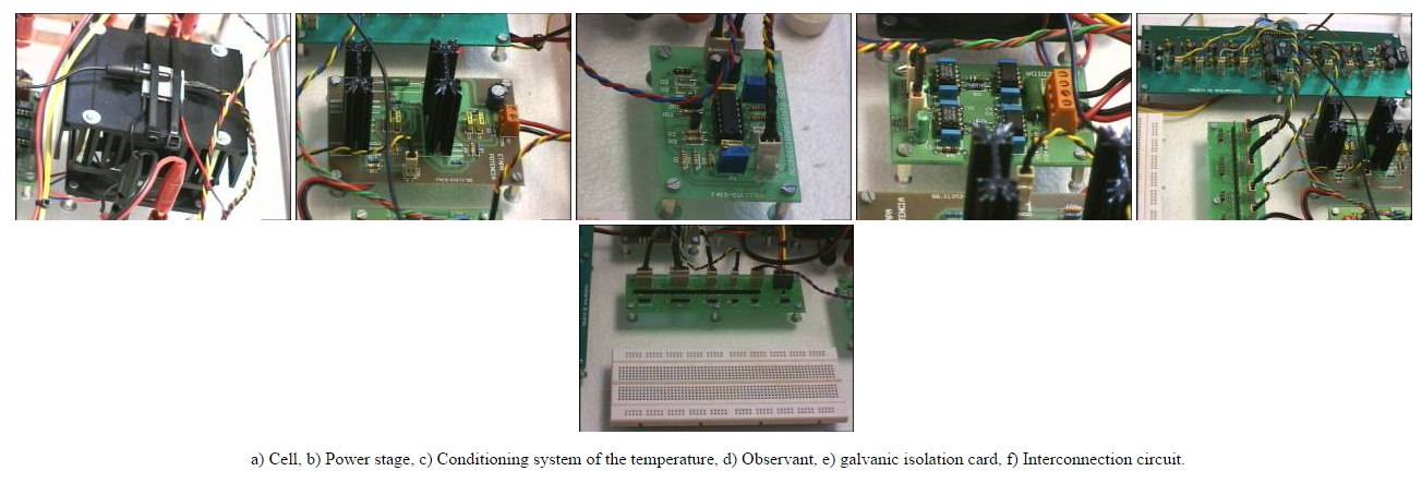

I have done a practice this year at the university called "Continuous control of a Peltier Cell" but for my shame, I did not understand how all that work together because of my low electronics level, I did not see how the (electrical) connections were made and with the acquisition board, which channel correspond to what thing...
If you are able to understand Spanish, I could give you the whole process and connections and explanation (my practice HandBook) in which it is explained from the very basics to the data acquisition and whole software/hardware used.
This is our peltier cell.
Here is a very little explanation in english about our cell **broken link removed**
My teacher really liked the Peltier Cell and done a great work but it is a pity because me and other classmates were not very excited because we did not quite understand its functionality because of those electronic boards and process...

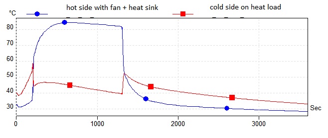

i did a setup at my system with data logger on its hot & cold side. the measured Vrms = 15V, measured Irms = 3.6A, power = 54W. Differential temp of both sides approx around 40 deg C.
I started to notice the hot side is not ramping down fast enough, could be due to fan n heatsink cooling not good enough?

here is the temp records:
Notice that although its cooling like mad producing a high temperature differential, the cold side is still well above room temperature.
Its not really cooling at all unless you can pull the cold side down lower than room temperature.
When the power is shut off, the cold side temperature falls to a lower temperature than when its supposed to be cooling. Its not really doing any cooling at all.
You need a much bigger heat sink to get the hot side down closer to room temperature.
And try it at much lower power levels than 56 watts,
I think you will then start to see the cold side gets colder than room temperature, which is what this is really supposed to do.
If you can get the cold side down to zero Celsius and see some ice form, then you can say you have really made a cooler.
And that will not be easy.
Something is really strange here. It is heating up the hot side but not cooling the cold side. 50W of input power will all appear at the hot side, true, but is the device really working well?
I will call it "cooling" only when the cold side goes below the room temperature. Perhaps it cannot handle 50W, one must start with a lower power level.
Something is not as expected.
Its exactly what happens if you feed far too much power into it.
The efficiency drops to zero, then well below zero as more heat conducts through to the cold side, than the cell can pump from the cold side to hot side.
You end up having TWO hot sides !
If power input is greatly reduced, it will begin to work much better.
