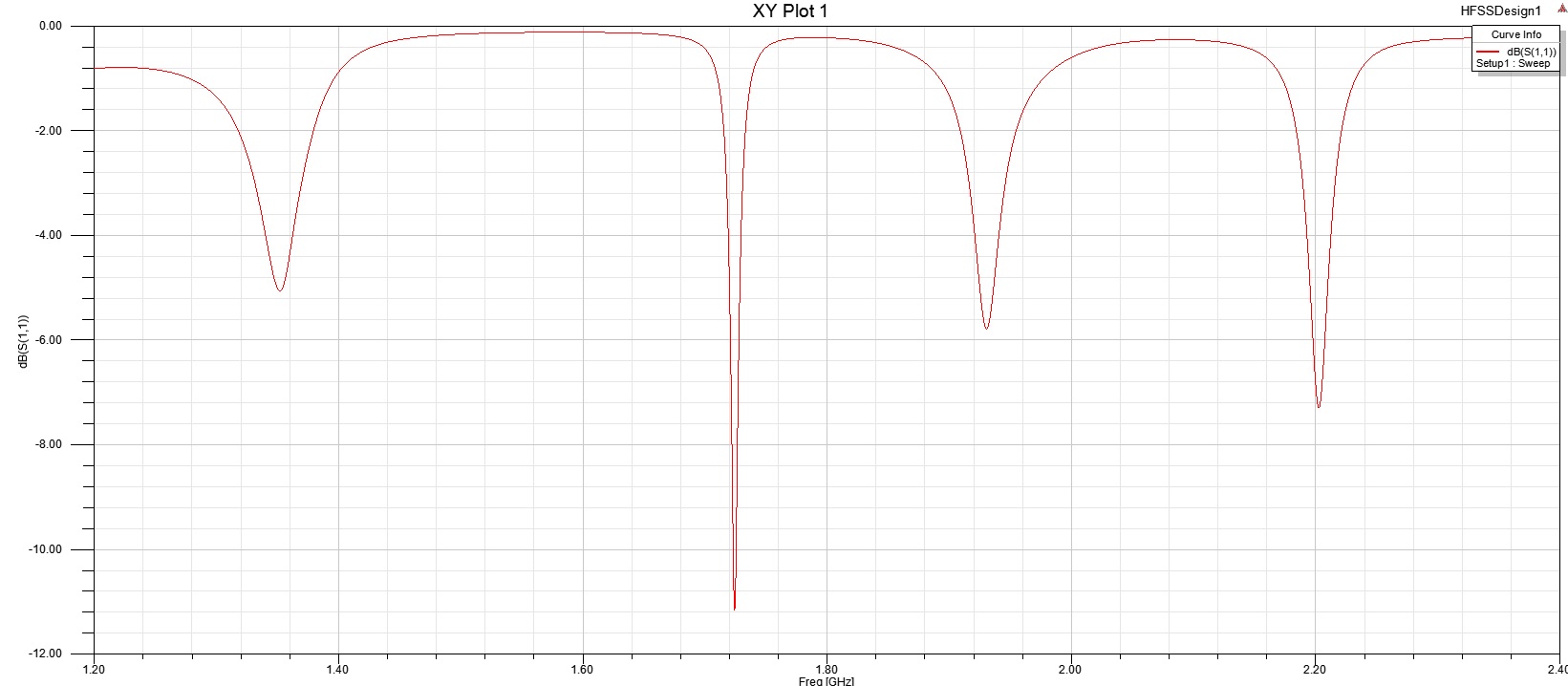

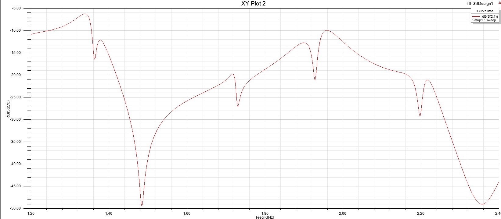

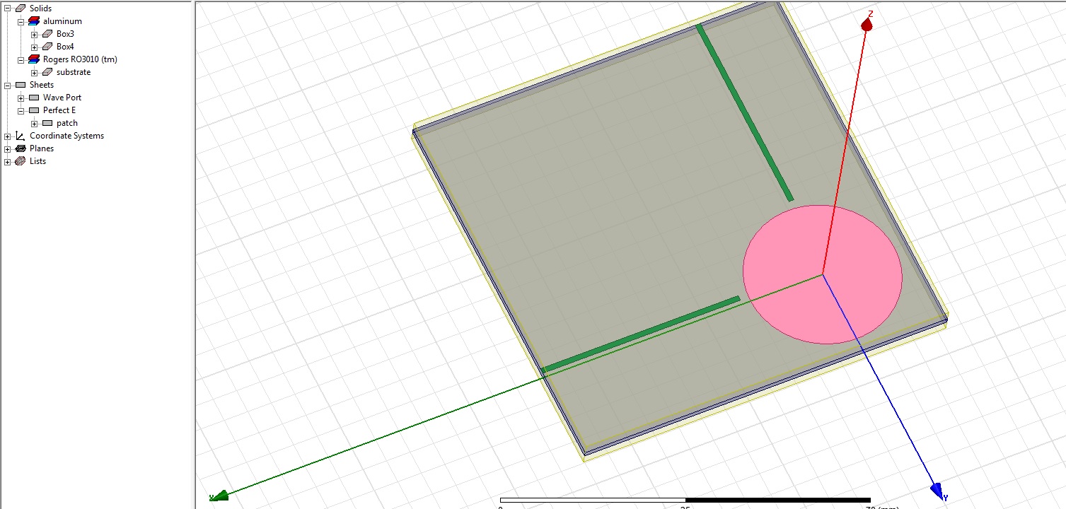

Hello,
I am newbie in HFSS and would like to ask about dual mode filter design.
I am designing dual mode SSS filter at frequency 1.8GHz using RT3010 with dielectric substrate 10.2 and height 1.27mm. the radius of the patch resonator was obtained from equation a= (1.8412c)/2pi f (dielectric constant)^1/2 .I did my simulation but seems like something is wrong somewhere here is my question :
1)how exactly to calculate the length and width of the feed line?
2)how to calculate the dimension of slot/notch and position slot/notch in HFSS? I have read in few books mention about the slot/notch must be located symmetrically 135degree from output and input port in order to create dual mode, but don't see any equations to calculate the dimension of the perturbation.
