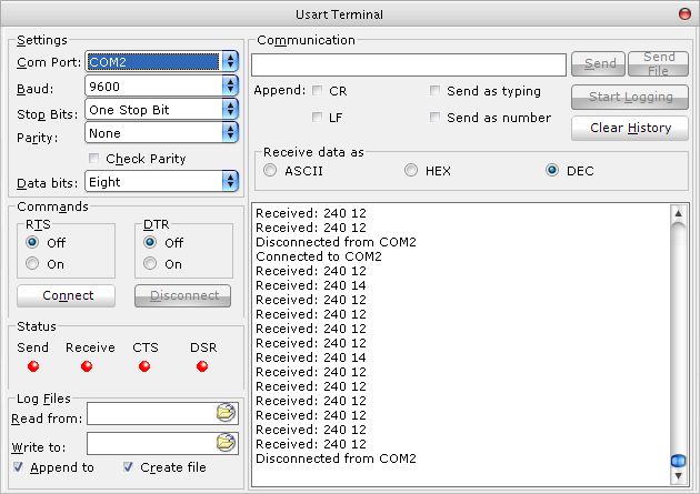

From the code above, do u see any wrong doing. pls help. What i want to know is that, why the number for this chattared keeps alway changing itself.

it doesn't work. Infact, that the character doesn't change when i give different voltages for the adc. this is what i got from the usart terminal of the microC
