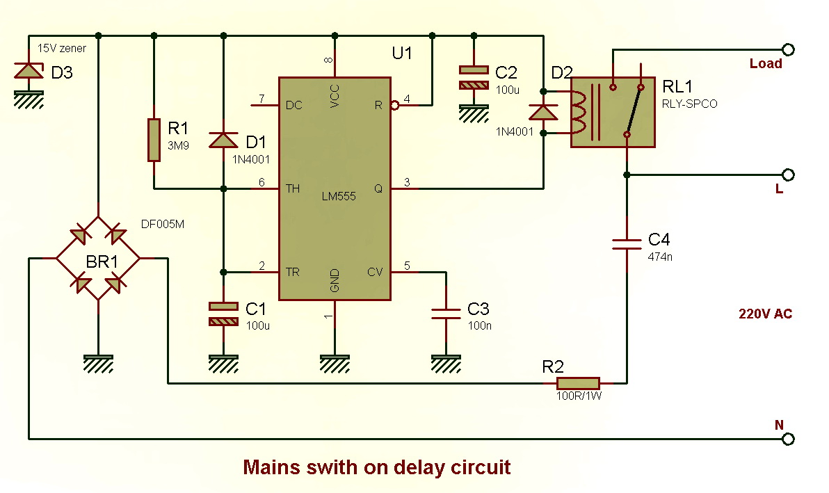

Impimenting fixed time delay everytime when mains is restored is easy like in this schematic. R1, the timing resistor can be upto 2M2 ohm for longer periods.
But the rquirment as in post #1 can be acheived. It is better becuse it will minus the time when mains is off from the four minutes and give a delay of remaining time. If mains is off for more than four minuites then there will be no delay thus improving efficiency.
It still uses a capacitor which was fully charges when mains was present. When mains is off it is slowly discharged to a certain level in four minutes. When mains restores, circuit stars monitoring voltage on it. When voltage drops to pre dtermined level, output is enabled and capacitor is charged to the full potential also.
The shown circuit provides power-up delay with a not so well-defined discharge behaviour for short power drops. But as shown, it can't achieve the specified 4 minutes minimal power-off, I think.

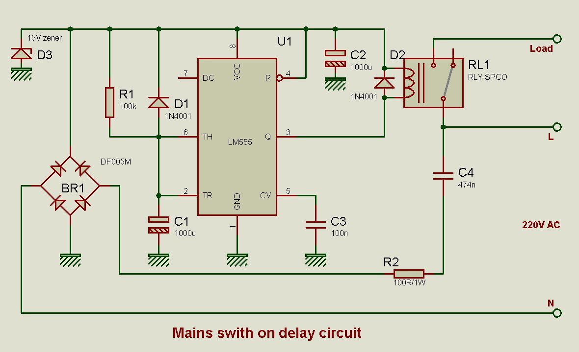

Yes it take few seconds to discharge through relay and circuit. Timing capacitor and filter capacitor values can be as low as 100uF for further speedy discharge. A fridge compressor can withstand a short period a very small power break.
With updatd values,
With updatd values,

When power is applied, first timing capacior is in discharged state and relay is in off position. The capacitor is slowly chargs in 4 minuits.When its voltage exceeds 2/3V of supply voltage, output at pin #3 activates the relay and load is on. When mains does off, supply of circuit also tuned off. The filter capacitor and timing capacitor are discharged quickly through relay and circuit. The circuit waits for mains to turn on to deliver another delay before turning on the load( althogh power to the circuit is off).
Relay is initially off. After delay time is elapsed, it is turned on. When power goes , there is no power to circuit or relay. It cannot remain in on position. It remain in this condition when power is applied again. After power turns on, the relay remains in off position for another delay time. C1 ,Ri are timing network. C2 is filter capacitor for power supply. C is ripple filter and C4 is used to convert 220V to 12V.

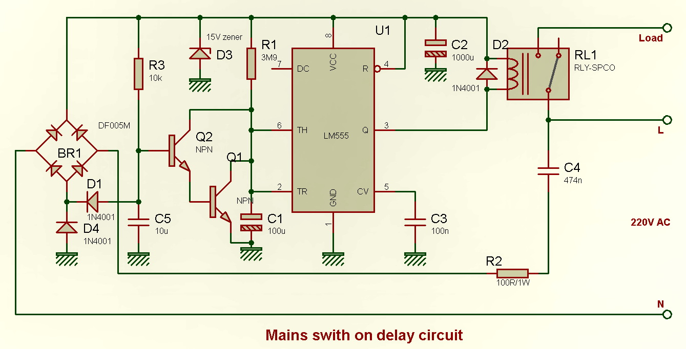

For fast swithing off response as pointed out by FvM, here is another version with a few additional cmponents.
Here the timing capacitor is discharged very rapidly.

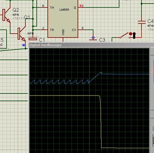

Trace showes when mains voltages are gone, darlington pair is trigged withen two or three cycles and discharges timing capacitor as shown in lower trace. It also help for more precise timing.

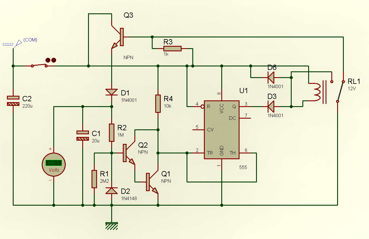

This circuit works as desired.
Switch cuts power to the circuit simulating mains is turned off. Relay is imedeately turned off. It does not matter how many times mains is turned off/on until delay time is passed. Then relay is activated. Other contacts of relay controles load which are not shown. Supply can be transformerless as before or a small tansformer can be used which also provide isolation from mains.
