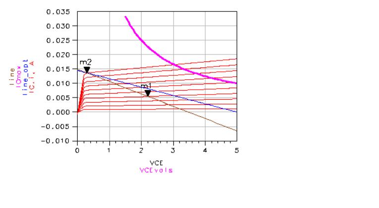

i going to design power amplifier by ADS .but in DC simulation i cant plot load line inn I-V curve. can help me?
In ADS Component Palette, there is a IV Curve Tracer element to obtain for BJT and FET transistors.Use that..

thanks for your guide .and how can i select best point in IV curve for (for example) AB class power amp?
"The Best Point" is quite variable for the active device which you intend to use.Therefore, you should select a appropriate point and then try to optimize this OP in according to you specifications.

this module (DC_FET) can plot just IV curve i am seeking the manner that plot load line on IV curve like this image :
https://obrazki.elektroda.pl/8217285300_1390335972.jpg
and which can i select best point for AB amp?
Those 2 load lines appear to be simply equations that we manually added to the graph display for the IV curves. Something like this:
thanks for your guide. but a question : what is the constant parameter (for example .015 , 226.667 in line equation ) ? for my FET model how can i determine them? I'm sorry for the stupid question
These are just numbers that happen to work for the example case. The 0.015 is the point where the line crosses the Y axis and represents the maximum current through the transistor. The 226/333 numbers are the slope of the load line and would represents some sort of (load) resistance. There is no way to get ADS to automatically generated these lines I just demonstrated a method of entering them manually.
