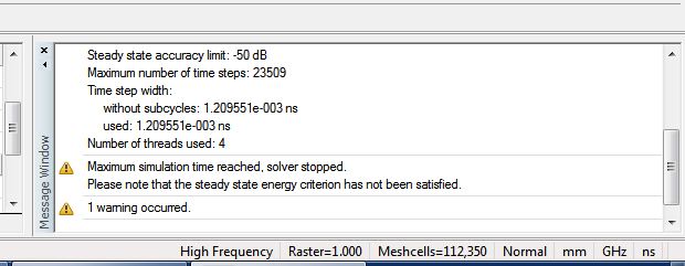

CST MWS Error Transient Solver
I don't know if this will work, but in the transient solver choose --> "Adaptive mesh refinement button" --> click "adaptive properties" --> then try to increase the number in "Maximum Number of Passes"
When the transient solver has not been satisfied, it means there is a problem with your structure, mesh definition or boundary conditions. What antenna are you simulating? If it is a patch antenna, check the port dimensions and check the port is touching the microstrip feed. If you're still having problems you can post the file or any other details.

I UC-EBG structure used an antenna in CST MWS.
Boundary conditions do not change? What changes do I need to apply?
I need help,General guidance If you can give me would be appreciated
