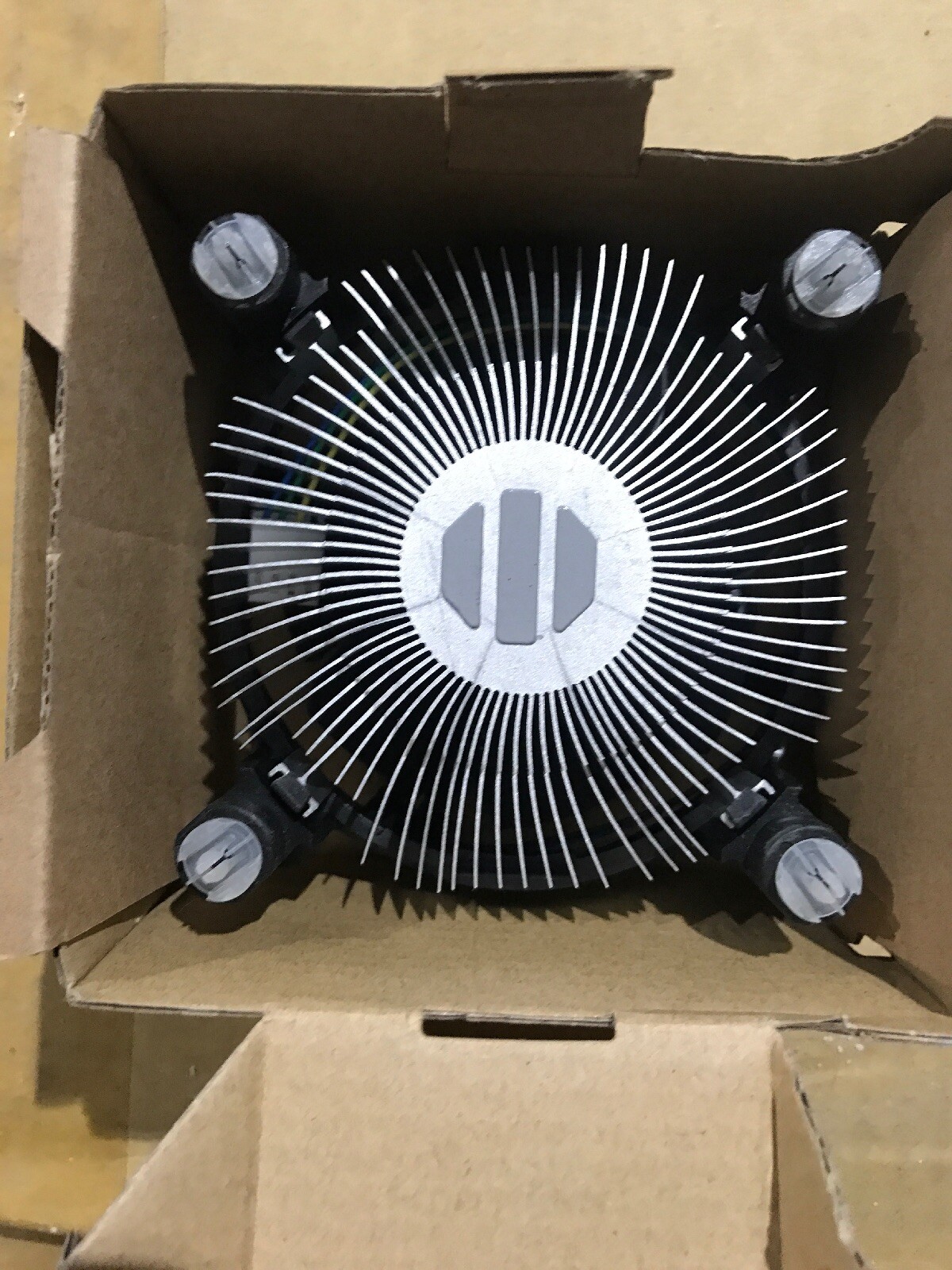

I use lower thermal resistance thermal grease made for PC CPUs - silicone is far less expensive and a worse performer.
