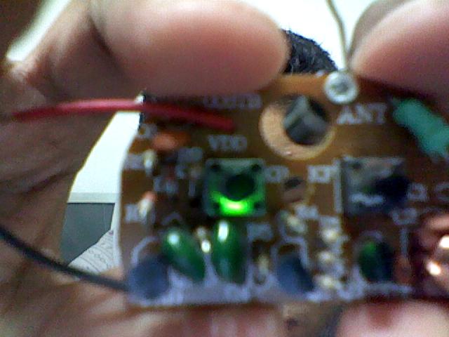

Do you have the model numbers of the TX/RX pair?

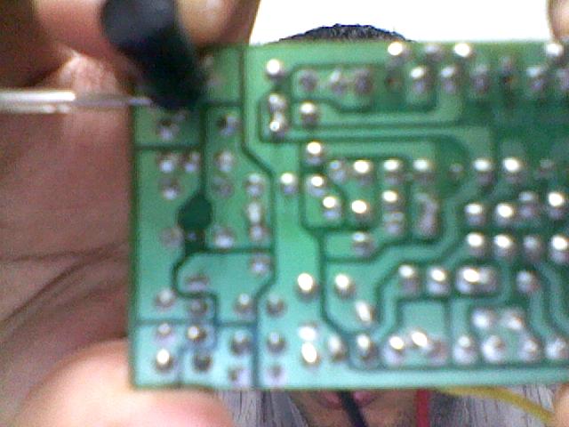

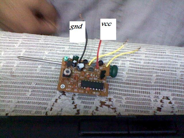

From where did u taken the demodulated data (in Rx) ?
If u could draw the circuit diagram of receiver then i think experts here could help U.
More over, i think u have to make it sure the connection u had taken from the receiver is the exact demodulated o/p.

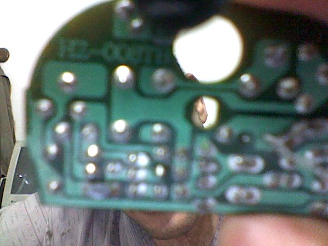

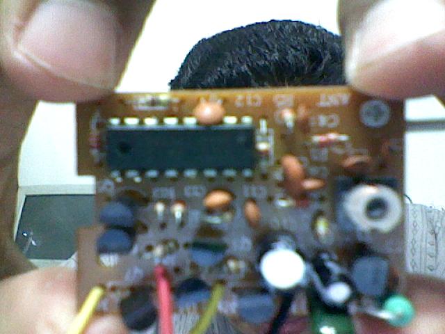

What are the markings on the IC?
It's hard to tell by the photos, very blurry, what the pair may actually be.

I think the receiver circuit is similar to what exists in ic datasheetOR u should some how draw the circuit and post it here so that many analog circuit designers and experts in this forum could help U.
Maybe by analogy to the way pulsed IR is used, mamech could pulse the encoder frequencies (forward = 1KHz; reverse = 250 Hz) and use the detected pulse widths at the forward (pin 11) or reverse pin (pin 8 ) for two channels of data. In a very simplistic application, for example, a pulse width of 1 mS would be a "0" and 2 mS would be a "1". A more practical approach would be to use Manchester or other similar-purpose encoding.
As an alternative, pin 11 pulses would be "1" and pin 8 pulses would be "0."
