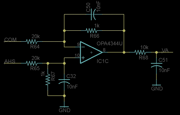

how am i supposed to measure the motor voltage , in both directions ?? can you clarify a bit (should i enter both motor terminals to a OP amp or something ???)

Using a differential amplifier with a LPF is one simple way, yes.

The differential amplifier you sent should measure across motor terminals.
Note that common mode rejection ratio of the circuit will be critical to sense motor voltage properly --> Use matched precision resistors (0.1%) for the amplifier circuit as well as low tolerance stable capacitors C0G / NP0.
for noise purposes ???
and another question does the rail to rail voltage of the amplifier should be higher than the motor voltage ?? example if motor is 24v , can a +5/-5 or +5/GND OPAMP work ??
as i recall from electronics the maximuim output of the OPAMP is Vrail+ and Vrail- . please explain .
You have 2 options:
Either use an opamp which can be supplied by 30 volts or use a voltage divider from the motor terminals to use a lower rated amp.
There are some "over the top" amps from Linear Tech which may also work....
