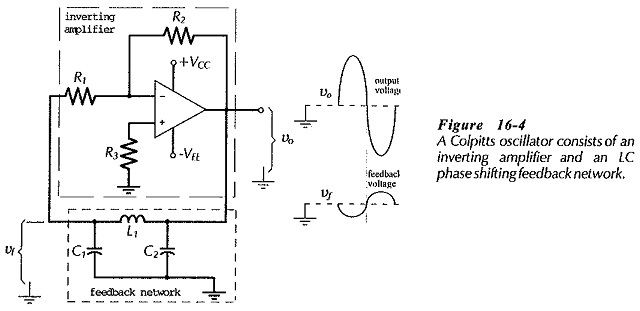

also building a Colpitts osc with known C values - if you can measure the freq of oscillation - you can calc the L
