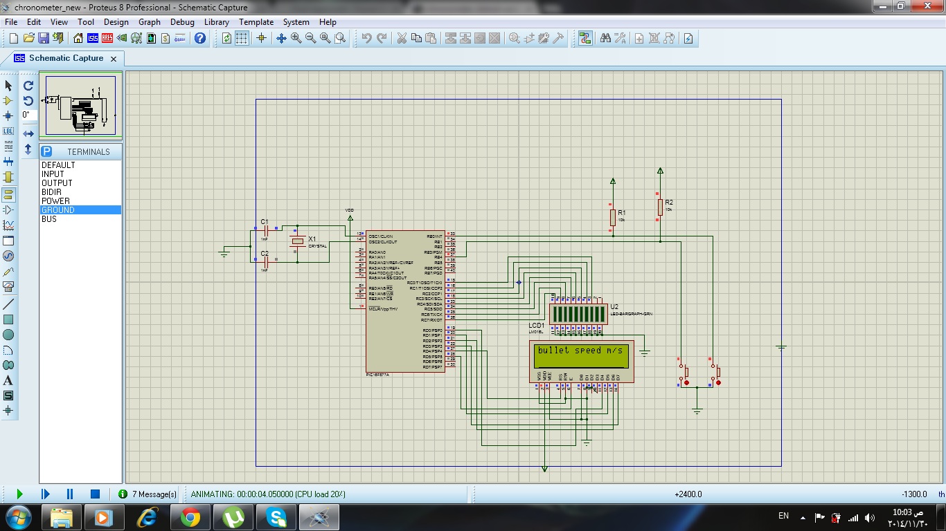

First you need to put ±10K resitor to MCLR pin in microcontroller to VCC!!! Its is called PULLUP Resistor!!! Many do not put this resistor and it does not work well in the real hardware!!!
See example:
Send source code and and real hardware schematic, and schematic proteus!!!
the source code is inserted in the post the protues image is herechronometer bullet spee.jpg

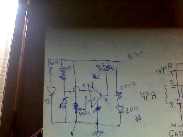

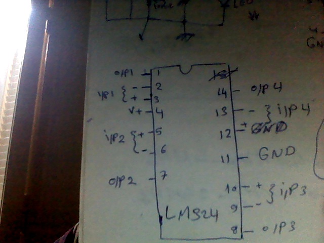

i use lm324 opamp instead of the buttons to make the interrupt and 2 potentiometer to adjust the threshold that will trigger the counter to estimate the time
this is the lm324 op/amp cct drow url:
port c show the interrupt counting each overflow of the timer in progress and the final result is displayed in the lcd as speed m/s
Sorry have no time to redraw the circuit in Proteus and create a new mikroC project just to compile and test the working. If possible Zip and post the complete mikroC project files and Proteus file.
As shown on your schematic the load capacitors for the crystal C1=1nF and C2=1nF are too high. They should be between 15 pF and 27 pF.
in the real design i change them with 30 pf cap andalso, the simulation run very good the problem in the real design on the bread board
i am trying to measure the speed of air gun pellet it is around 1 cm long and 220m/s speed that means need 0.01/220 seconds to sense it ie 45 micro second i use the lm324 op amp is this op amp speed enough to measure my interrupt signal pls help
