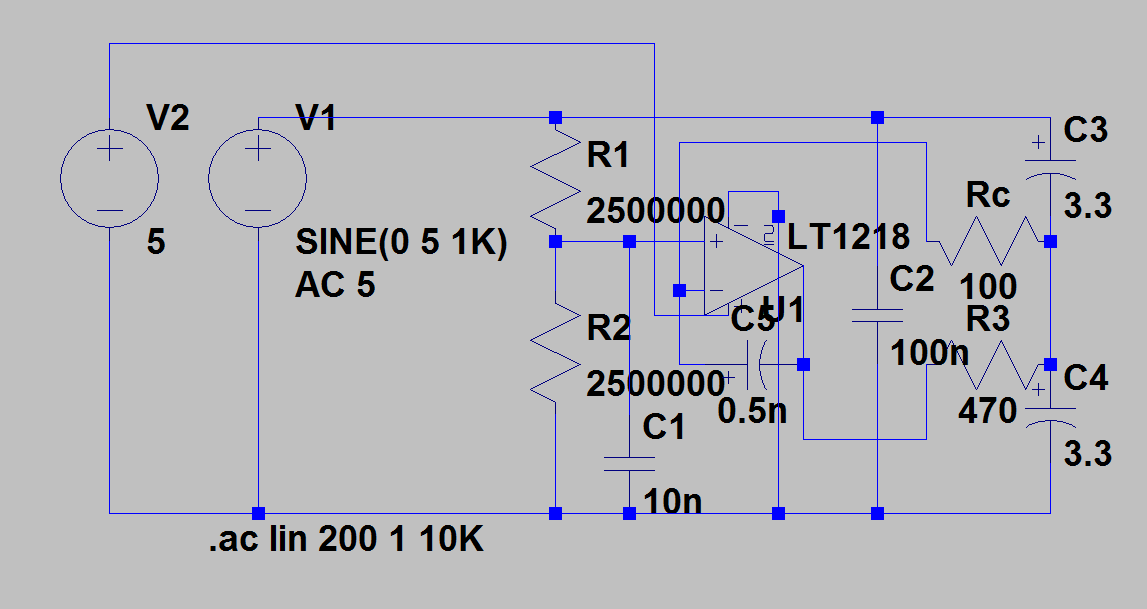

Charging supercapacitors in series?
I was talking about a parallel high-pass, not removing the original DC connection of the OP.
The simulation setup surely needs some corrections, e.g the voltage source must contain a DC component to power the OP.
Ok thank you very much!
Yes I' ve already added a DC source but omitted to upload a new image.
Not much changed to be honest..
The output is full of oscillations .

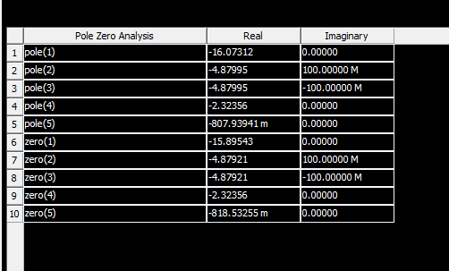

I did the same circuit in Multisim in order to get a pole-zero analysis and I see that almost every zero negates the respective pole
which causes the oscillations.
I tried different values for the compensation capacitor and resistor but it did not change much :(
For Rc=1.25 MW negative feedback reistor =330 W Cc=0.5nF it works in practice.
