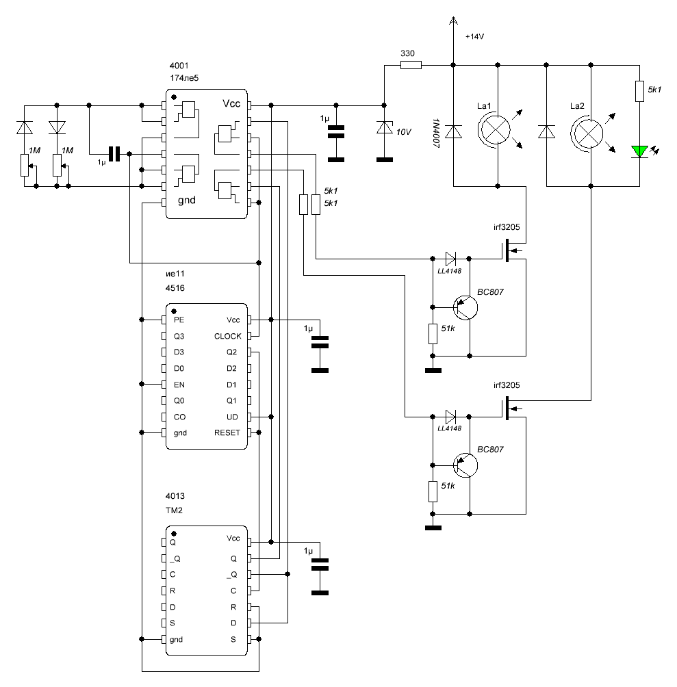

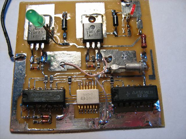

in principle nothing especial, if not to count outputs protection from short circuit and auto cut-off when batteries depleted.
