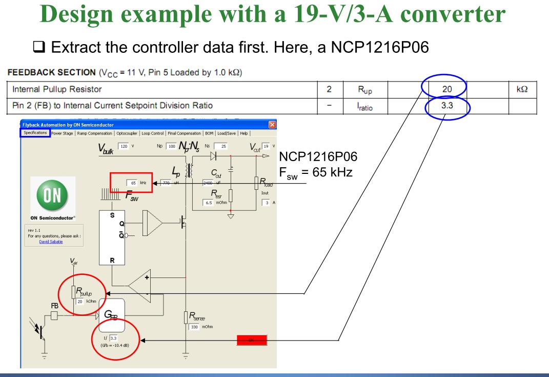

Hello,
We are doing a sub 1W, offline, DCM Flyback SMPS with the Viper12 PWM controller.
We have a main, regulated output of 5V, 0.5W, and an auxiliary rail of some 18V, 100mW, which we use to power the viper chip itself.
Page 30 shows schematic with “R(pullup)” resistor in series with the opto transistor…
http://www.st.com/web/en/resource/technical/document/application_note/CD00077926.pdf
We wish to calculate the feedback loop gain and phase margins, and to do this we are using the equation 3-66 on page 292 of the Basso book (as attached). To use this equation we need to know the value for “R(pullup)”.
What is the value of the “R(pullup)”?…..is it 10K? (R2 in above st.com schematic), or is it 11k, (ie 10k plus the 1k inside the viper12A)?
The error amplifier schematic , showing R(pullup) is on page 296 (attached).

if using vout, then ipk needs to be referred to the secondary, but they don't do that.
The flyback equation is the buckboost feedback equation but adjusted for turns ratio.........they don't adjust for turns ratio...I wondr why?
The opposite is true. By relating Vo to primary Ipk, you get the "gain" of the flyback converter, including the transformer ratio. Just a basic behavioral description.
Please notice that the gain ΔVo/ΔIpk is a small signal quantity, valid for a particular operation point. To derive the value in a calculation, winding ratio, transformer inductance, switching frequency and duty cycle (at least these) have to be put in.
Referring again to the above document about DCM flyback, and for stability calculation...
https://www.st.com/web/en/resource/technical/document/application_note/CD00077926.pdf
...Do you agree that the gain and phase margins must be calculated by multiplying equation 23 (page 14) by equation 19 (page 12).?
Also that "RL" on page 13 actually should mean "load resistance" and not "inductor coil resistance", and that "delta V0" on page 12 should mean "change in vout" , and not "output voltage ripple"?
