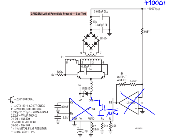

To do so, it must be CURRENT FED, which essentially means an inductor in series with the supply.
In this instance, said inductor is the one that connects on the transistor's emitters.
This is similar to what one does for fluorescent ballasts. The inductor prevents cross conduction losses.
In my application I'm using a 150uF coil at the emitter of the transistors,
the transformer is coiltronics CTX210659 (20uH/1:100), Cpar=220nF,
so this should be then a "current fed" topology im my case
the circuit is based on the Linear App-Note ANN-118, Fig.11, with the difference that I don't use the LT1534 controller
I'm trying to optimize the circuit, started looking at the high supply current of 120mA/5V without load, I hoped to find in the book some information on the dimensioning and the expected waveforms of the circuit,
normally I shouldn't be concerned much about current without load because I anyway shut it off most of the time, but it could be a hint that there might be something wrong
If you supply the circuit with constant voltage then the base resistor wiill set the supply current respectively output power.

Thanks for that input, that is something I should try, I anyway would like to be able to tweak the circuit by an microcontroller, switching between different base resistors could be one option
btw: here is a picture of the circuit,
(instead of the CTX210609 I'm using CTX210659,
same inductance and turn ratio but different power spec)

Excellent attitude! :):) You are correct, a high idling current means that something may not be quite right. The investigation will allow you to decide whether a design change is required or not.
Do you have an oscilloscope? If so, take primary waveform readings with the circuit as is. Save those waveforms and then start tweaking your circuit.
maybe one problem is that I switch on the FET at the bottom for too long time until the coil at the emitters goes into saturation, (I don't know if also the transformer coil could go into saturation),
actually, the MOSFET and the coil seem to be kind of buck or boost ?
