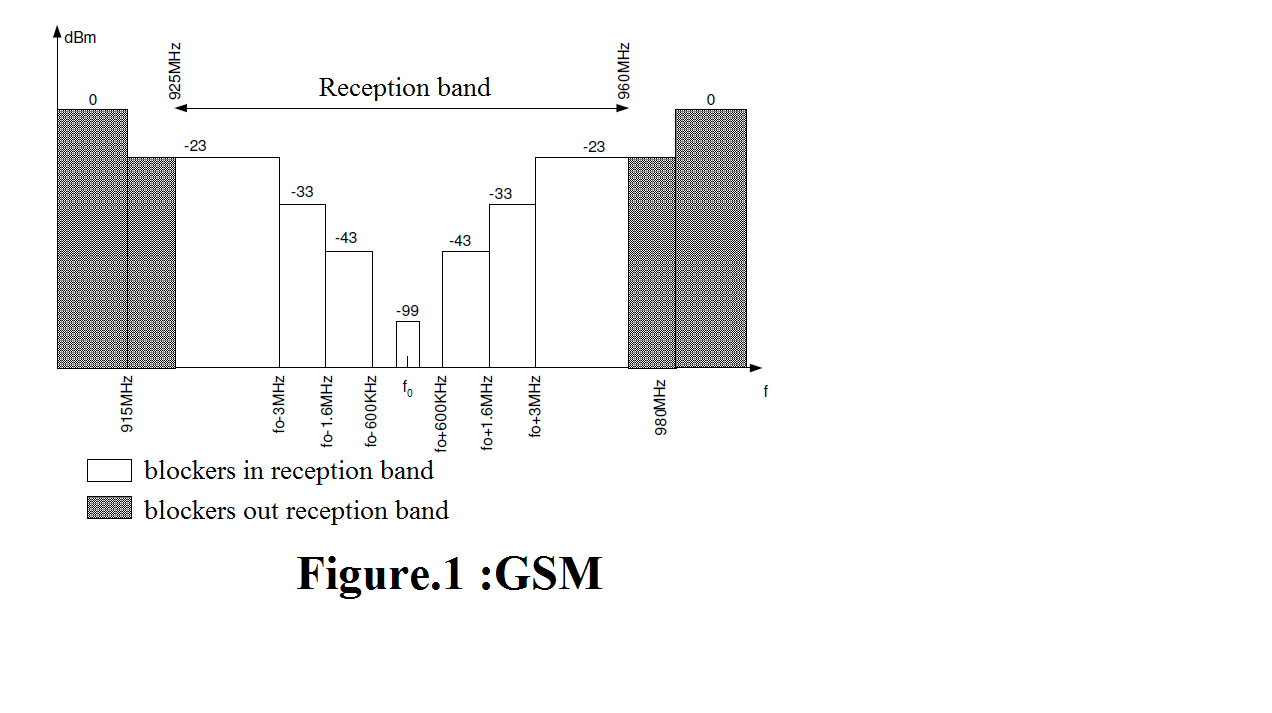

hello,
This is a profile blockers for standard GSM:
how we can define profile blockers specifications for unlicensed wireless ?
This an example for unlicensed wireless:
we have a free band frequency 7MHZ (863-870 MHZ), sensitvity@1% is -102dBm, maximum output power is 0dB(1mW) and Modulation is BFSK.

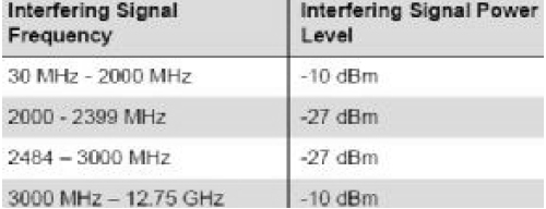

From my knowledge only cellular systems as (GSM, WCDMA, WiMAX, CDMA, etc.) and Bluetooth, have RF specifications for blocking. But this doesn't means that other RF systems will work fine with any blocker present at the input.
See the attachment for Bluetooth blocking requirements, and you can implement somehow for Zigbee.
The blocking signal is CW and the wanted signal is 3dB above the sensitivity level.

Hello ,
After a long a research i find the standard interferer profiles for 802.15.4 as shown in this figure.
But the frequency band is not indicated.
Can someone help me
Thanks for help
The delta 0M denotes the certer freq of used freq band in the 802.15.4 standard.
