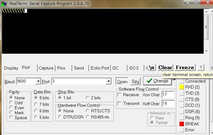

Hello Everyone
I've read some tutorial about Atmega8 USART.
I tried to write a simple program, which send a character 'a' to serial port.
I used Realterm to connect to MicroController, but received character was not direct (wrong text).
(I also tried to use Hyper Terminal, but sometime text is displayed in screen (wrong text), sometime nothing) :cry:
Realterm Text: https://i1275.photobucket.com/albums/y446/gonewiththewind1312/realtearm-config.jpg
(View in ascii mode)
Thank in advanced for anyone who help me to solve this problem.
Or, Any one can give me your code for this program (Send a character to serial port), and how can you run/test your program.
* Is there any error about character encoding ??

hi alexan_e, Thanks for your help.
What do you mean when you set CLKPR in above codes, why the left hand side is the same ?
Have you studied the datasheet of mega168?
There is a register called CLKPR that controls the divider of the clock (from any source).
There is also a CLKDIV8 fuse that can control the default value loaded to CLKPR at startup (clk/1 or clk/8).
Ok, I see. Thank for your help.
CLKPR = 0x80 ;
CLKPR = 0x00 ;
I've added two line about to the first line of main().
In Realterm screen, Received character is also special character (strange) in ascii mode.
So the problem isn't solved. Can you give me another solution?
__I also try to use pyserial (python) to receive data from Atmega168, The result is very strange character, seem like Chinese character :(

I've change and F_CPU,F_OSC from 16E6 to 8000000, also add CLKPR = 0x80 ;CLKPR = 0x00 ; to the first line of main().
So it works correct :)
May be problem solved.
But I want to ask you about setting Clock Frequency.
When I learnt to use ADC converter, My program only works with F_CPU is 16E6. But this case, may be 8E6 is only one solution.
So, How can I set F_CPU or F_OSC in a direct way ?
Thank you very much for your help :)
What you refer to is just a define that stores the clock frequency value so that libraries that need to use it for calculation like the delay.h know what frequency to use.
This define does not change the hardware clock.
The hardware clock can either be changed by changing the divider using CLKPR or change the fuses and select from internal RC which is the default source (8MHz) to external clock , crystal etc.
