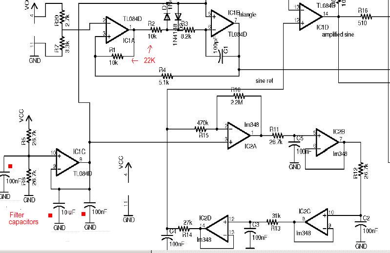

I try to make a converter like the one in the pdf file. I start with
the oscillators. The 50Hz oscillator give no problems, its working on 50Hz.
The triangle give a problem, as you can see on the picture, the triangle output, have a big distorion. The opamp I use here is
lme 49740. The distorion is there with low freq, 2.6Khz but too
with 22Khz. I have used 100, 10, 1 nF caps but still distortion.
The square is no problem, so I can't see what is going wrong.
Is here someone who can help me?
Thanks

Thank you for your reaction and your answer. The link comes by a real good explanation. So the lme have +10V -10V, if this means by max Vcc then it"s clear why it"s not working, still the square is good.
I use 12V >> 6V on the + input.
It cost some days to get the TL084.
I will do some tryouts what you advice, adjust the resistor and capacitor
The waveform you got is probably due to sqarewave ripple on virtual ground (6V). It may be not of low impedence and IN4148 diodes may be causing this modulaion. You can observe this using scope. Add filter capacitors, remove diodes, adjust amplitude by R1,R2 and symmetry of wave by adjusting combination of R7,R20.

You have understanding of this subject, it was indeed the 6 V offset.
I used for both opamps the same 6v, when I use an opamp to create a 6v and supply to the integrator the problem is solved.
And without the 2 diodes.
