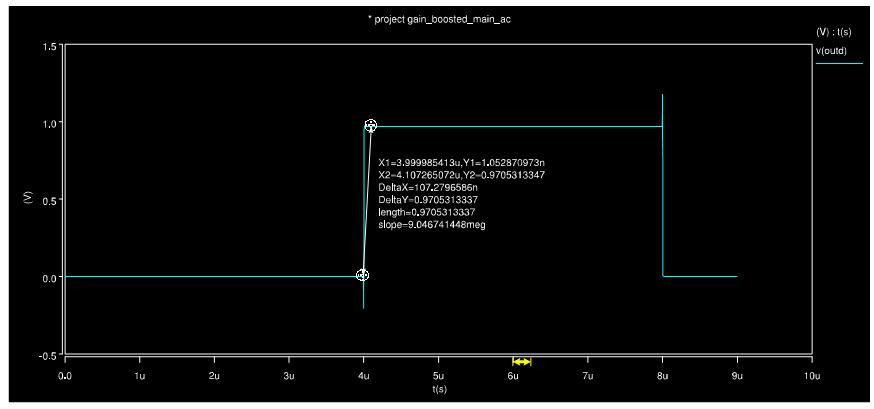

Hi all: I am designing a full differential amplifier, the DC GAIN is 45dB, and the GBW is 403MHz, PHASE MARGIN is 66°
During the transient analysis, I use the following statement as the input of the OPA:
VID VID 0 PWL (0 0V 4U 0V 4.0000001U 1V 8U 1V 8.0000001U 0V TD=0)
but when I observe the output wave, the maximum value of the output port is only 0.97V, other than o.9999V.
At the save time, the settle time is too long. It's cost 108ns to get the maximux value, i.e. 0.97V.
How can I improve the maximum value and the settle time of the OPA?
Help me please, thanx!!

the output wave is like this:
firstly, i think you should make sure the output of the circuit can reach the desired 0.9999V or not, just add an unit step function instead of a square waveform. and check it costs how long to reach that final level.
Reactions: wjxcom
    wjxcom
Hi prcken: how can I realize the unit step funciton?
like this, don't let the voltage back to zero
VID VID 0 PWL (0 0V 4U 0V 4.0000001U 1V 8U 1V TD=0)
