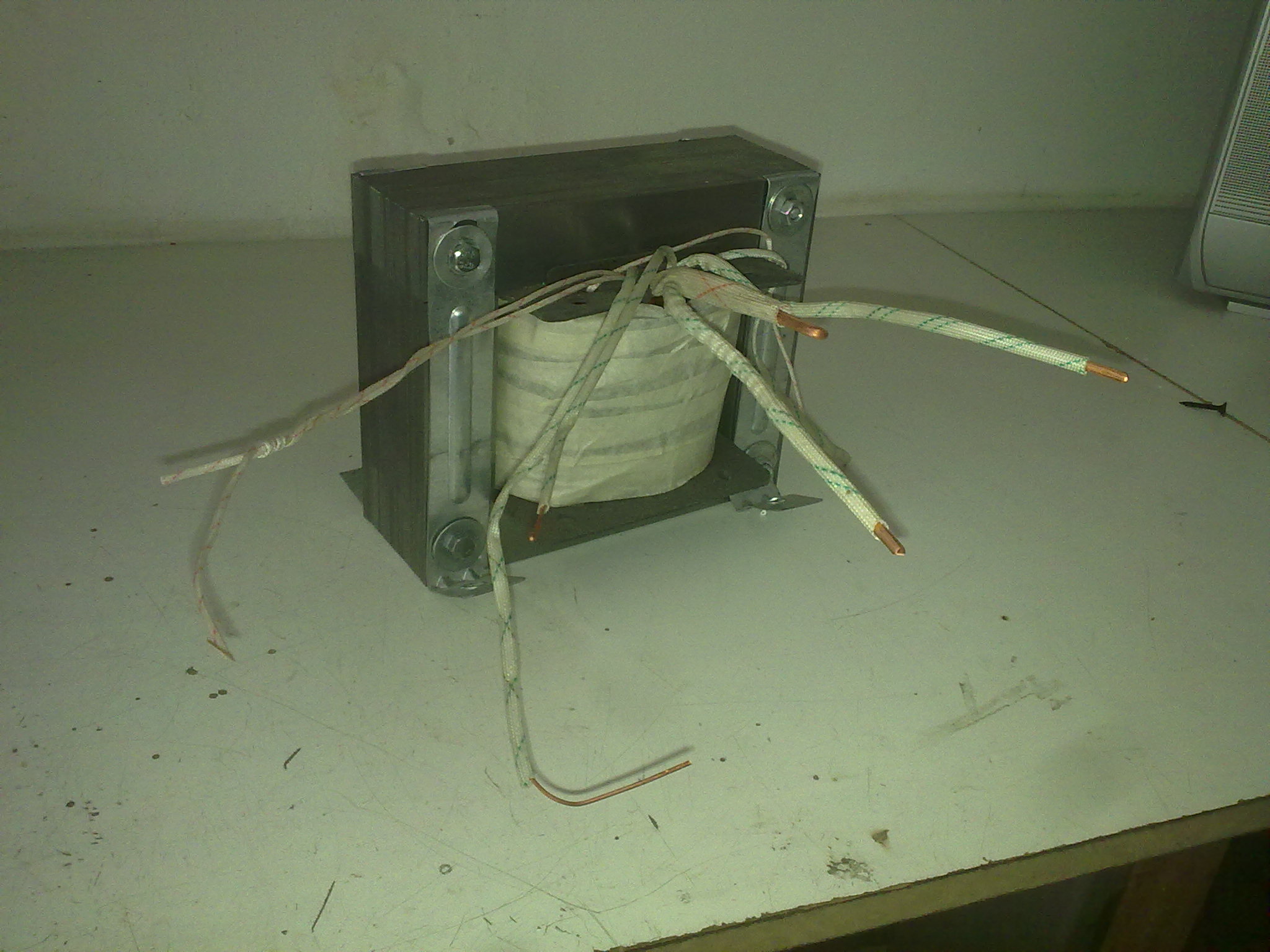

One year ago I have built 500 watt modified sine wave inverter.
I used iron core transformer (10-0-10 on primary,0-220 on secondary ),avr microcontroller , irfp064 mosfet transistor and 12v/100Ah lead acid battery .this is the schematic of my circuit and the transformer:
Now I want to build 9000 watt inverter . this inverter will drive 9 sewing machines , the specifications of each motor is (400 watt,two phase,2.9 amp and 2850 rpm).
Is my last design suitable for this power inverter ?
What is your advises ?
9 kW @12V = 660A, this looks like a severe problem. I think you must reconfigure your battery supply to 50 V. This would give you 9 KW/50 = 180 A still a large number but doable.
If each sewing machine takes 400 W, then 9 would take 3.6 KW, which is a lot less then 9 KW. In either case I think that you need to wind several primaries to split the current paths, else you will need to wind it with extremely thick copper bar.
If you duplicate the drivers and output stages and drive a separate primary from each one on a common transformer core. A "booster" on the output of the micro might be useful to increase its fan out.
Frank
What do you mean by wind several primaries , how its work ?
What is the booster circuit I need?

1. 9000/12 = 750 A not 660. As your drive pulses are on for 20% of the time, current flows for 40% of time, so you need a current of 2.5 the above numbers.
2. Copy the pin 8,9,10 arrangement on to the same core and connect it to its own output and driver stage.
